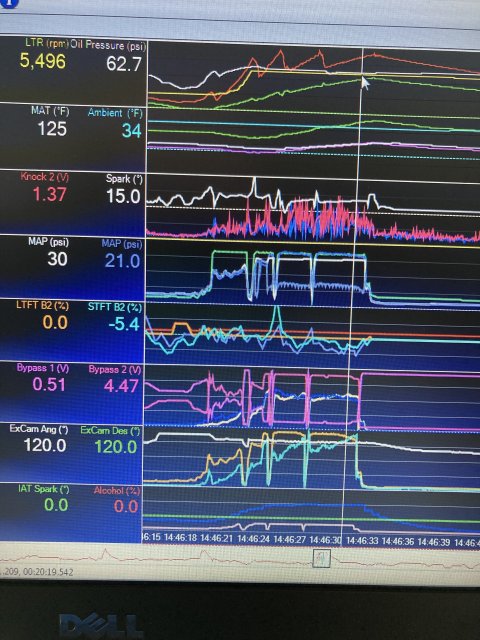

Well first hit, 3rd gear, 2100 aircharge from the 2.4 blower with a +10 lower and 2.74 upper. I don’t think this blower has ever moved this much air before, I’ll have to check past logs.
I think I have a pump going bad, brand new pumps :(

I bet you don’t have a pump bad. Without a bap the dual pumps aren’t going to support that. You have to remember da is better than the whipple ever saw

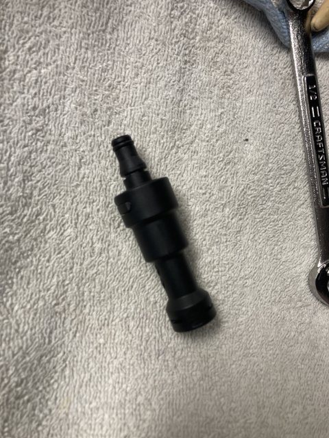

O, and BTW, this IS the Clutch Delay Valve!! No doubt different now. The RXT1200HD MUCH EASIER to start off with with NO CHATTER!!!
E9076DEB-1676-4369-9EA7-3BA6DDE8F6E4.jpeg FAC7B38F-4552-4254-9B2C-C062DFD00A5F.jpeg
I took mine completely out and the Bang Shift Billy took up the space is was in. It is easy to gut and then put back in place, and can be put back to stock just as easy too, just remember the sequence, above picture shows how the 4 parts are oriented inside it.

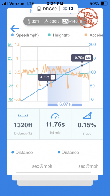

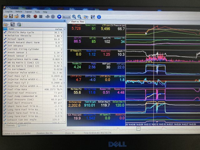

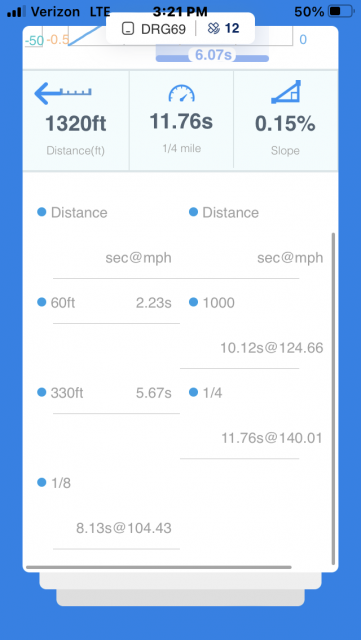

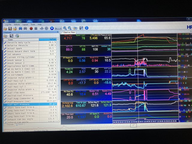

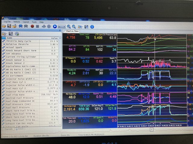

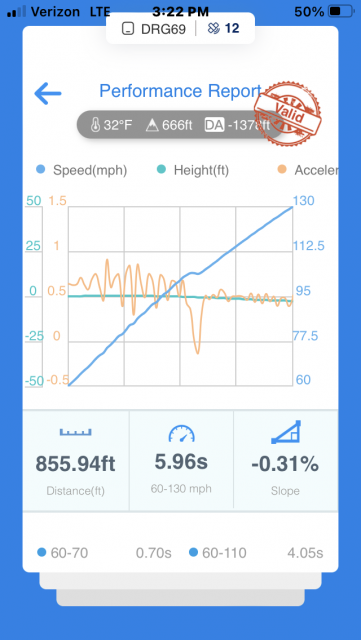

Dialing in the injectors, today I did a 3rd gear power pull up hill, a 60-130 run across the bridge and a 1-2-3-4 1/4 run back across the bridge and home, zip zip zip, all done in about 5-6 minutes. Saw over 2200 aircharge from this little 2.4 blower. Car running GREAT!! Motor perfectly smooth and quiet, the only thing one hears is the smooth whine of the blower, I’m in heaven atm!! Just what I need to go to my first day on the new job tomorrow. A big smile for the night!! 32 F, was 20 over night so bridge road surface cold🥶 lol, 60 ft sucked but still managed 140 in the 1/4 from the little 2.4!! And that’s only on a mild 15 degree timing tune!! Look at the log screen shots!! Now I’m wondering what the Whipple would do with 18 degrees 🤔

That's moving some air. Keep an eye on that fuel pressure. May be time for a 3rd pump.
Good observation, Something is up there but I’m not convinced yet it’s the pumps, the injector DC doesn’t correlate to the falling fuel pressure. I’m going to try a different set of rails first, going to put my original ported rails back on and see if it acts the same or not.
