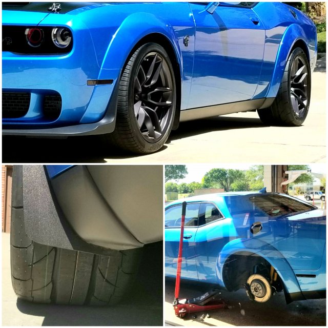

After having the 2019 Redeye for 1.5 years and 2300 miles, I could not get a good hookup under 60mph on the stock Pirelli's all season tires. Had Nitto 555RII 315 35 R20 installed on the rear. Not only greatly improved performance but think the rear profile looks better too. Have not yet driven in the rain. Traction improved, no increased tread noise and vehicle dynamics not changed.

FCA was an Italian based company and their tire sourcing was to an Italian tire company - Pirelli. Many years ago I had Chassis Systems Procurement and Quality responsibilities at DaimlerChrysler. One of which was a $1 Billion annual tire buy for the Chrysler Group. I benchmarked all US and European tire suppliers with my Mercedes counterpart and we concluded that Michelin was the world's premier tire supplier primarily based on their process and quality reputation. They are more expensive. Unfortanely for Michelin being a French tire company, Mercedes had a bias for Continental tire company being a German based company and tied support for their F1 program to tire sourcing. I have had Michelin tires on several performance vehicles and highly recommend them. I kept the Pirellis up front on the Redeye. Stock 20x11 Devil Forged Rims all the way around. Left Discount Tire with 34 PSI all tires. Have read to get better 0-60 times is lower the drag radials to 26 to 28 PSI. Next on my things to try..... Have only done a few 40mph rolls since getting the Nittos and it is like having a new car with much improved hookups....
