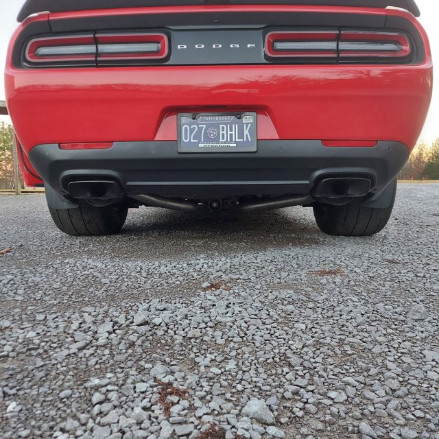

First mod. completed on the new hooptie today.

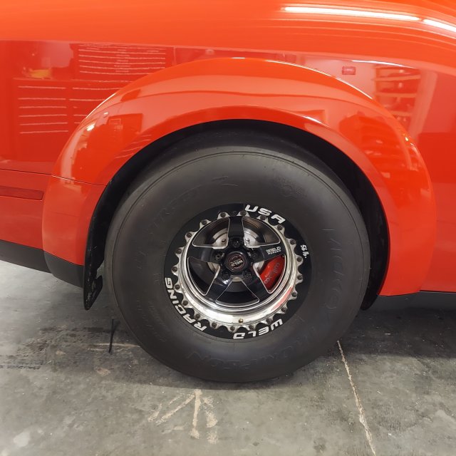

And these 315/60-15's are big. 20230103_170028.jpg

I bet it is a different car with those installed.
56 LBS.?

I don't know exactly what to expect from these tires Mike. I plan to run the car some this upcoming season and our local tracks aren't exactly known for being particularly sticky so this seems the way to go. On a killer track I'd say a good 17" might be quicker - solely from the weigh savings.
The 56lbs is the weight of that wheel/tire. For comparison my 17" Billet Specialties w the 28" Hoosier weighs 42 lbs.

Them’s some big ass tires ! Sure fill that wheel well nice.

They are big! They're pretty much all that'll go under the car.

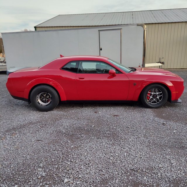

I got the seat finished up this afternoon and final installed. It's a 15ish year old seat that's been in my shop attic for the last several years so it isn't as pretty as some but it's temporary so it'll do.
It's on 4 wheels and turned around in the shop to begin the E85 swap. Hopefully I'll get the fuel drained tonight and start in on the injector swap tomorrow.
