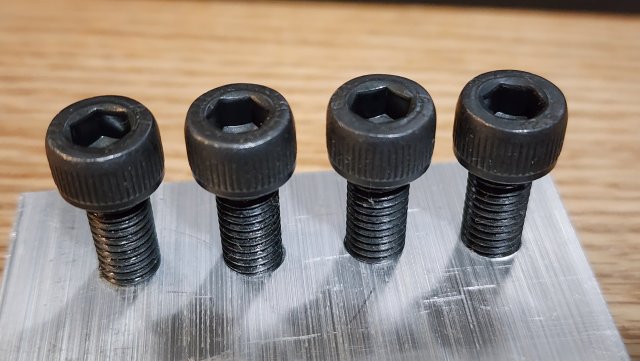

Now I want to set up a piece of scrap aluminum with a 8mm bolt and test it on my shop press to see what the actual fail point is...

I'd love to watch that video.
Challenge accepted, but it won't happen for a bit
I prepped the test piece, I'll work on shooting a video tomorrow maybe.
