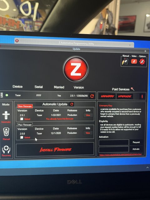

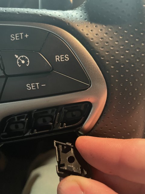

After installing the buttons, I cannot remap them. I also cannot remap any other button by holding the left arrow and then hitting the button. The car is in Run with engine off when attempting remap. So at first I thought it was the Tazer, did a full reboot, still cannot remap. Okay backed up, maybe the firmware has bugs. Went back one revision on 2.5.x and that still did not work. Then went back one revision to 2.4.x and that did not work. Unmarried the tazer, updated the firmware back to latest 2.5.x and then it still would not work.
Does anyone else have a 2015 Hellcat Challenger and has successfully remapped the buttons?

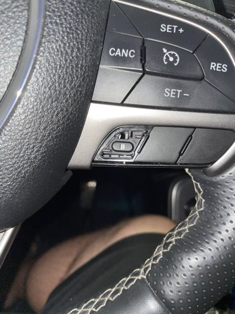

I had the Tazer on my 2018 Scat pack and did map the Track, Sport to the Steering wheel Adaptive cruise control buttons with out using the sport page button and it mapped fine with adaptive cruise off.I used the bypass harness that wired in the trunk to the battery to install the tazer becuase on 2018 you cannot wire directly in the port like you could with pre 2018 models. Then after installing the vehicle had to be in run position and not running make sure you are in audio in evic then you can cycle thru the menu on the tazer setting by using arrow buttons. If I recall properly you go to mapping, press the button you want to map then press the button you want to map to and that's it cycle on thru to full boot allow the tazer to finish with full boot. Hope this helps you.. I miss this simple function so much on the new Hellcat. Such an easy function and I do not have the adaptive cruise on the Hellcat nor did it want. I don't not know about conversion of the dummie buttons on the steering wheel but sounds like an excellent idea to me. Good Luck.

I feel dumb like Im the only person that can’t get this right. That or my steering wheel module is broken. Im going to take the wheel apart tonight and make sure everything is plugged in.

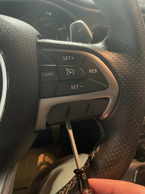

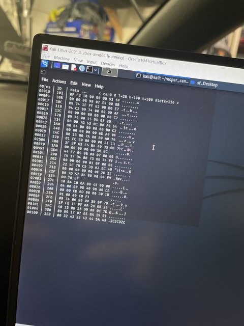

I did aome sleuthing, hooked up can bus analyzer to see if button presses generated any traffic. Nothing appeared outside of this already noisy bus.
16,057
50,350
Try removing the button and depressing the inner actual button and see if you get something on the bus.

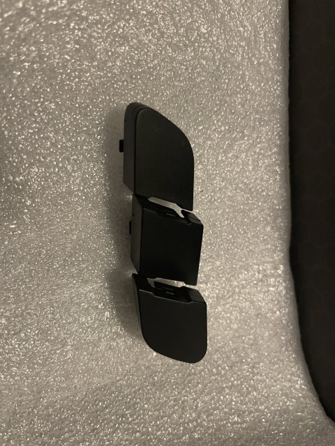

To clarify, I do recall something about a button change in the switch module between 15, 16 or 17
In the beginning, you had to change the switch module, then they came up with the button swap only method. But what's not clear to me is if this was a mechanical change or a parts sourcing change.

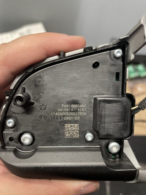

@fumanchu182
I might have to go this route. Took the cover off and hit the rubber directly, nada.

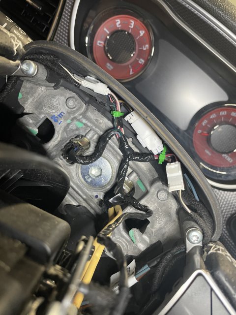

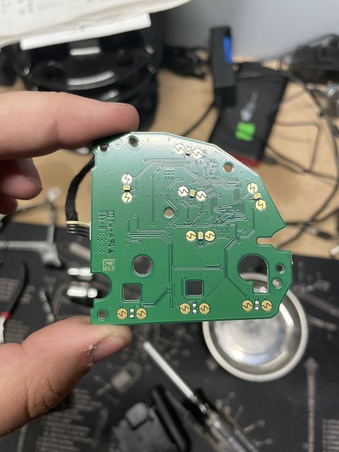

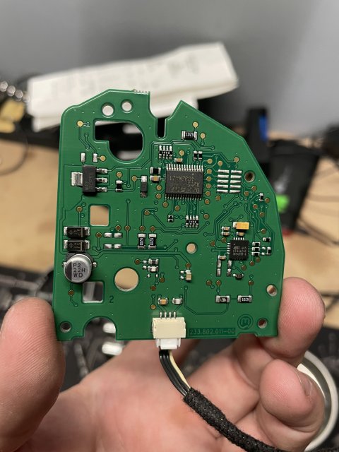

In decided to be adventurous and took the wheel apart.
Then from there I inspected the module when I got it out. Looks fully functional.
Tested continuity, tested ohms. Everything looks fine. Maybe this is one of those modules not programmed to work that way. Im willing to try another Tazer or button module. Ill try and see if my friends local will let me experiment with their Tazer. Ill try and ebay a 2016+ module.
