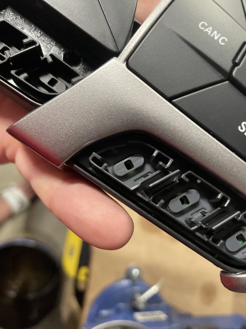

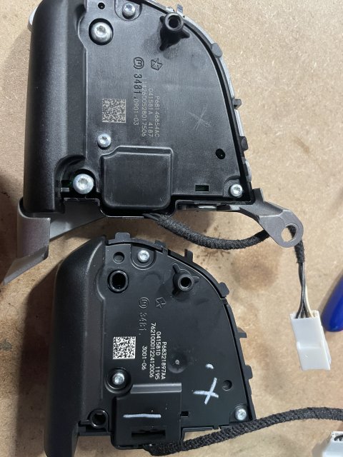

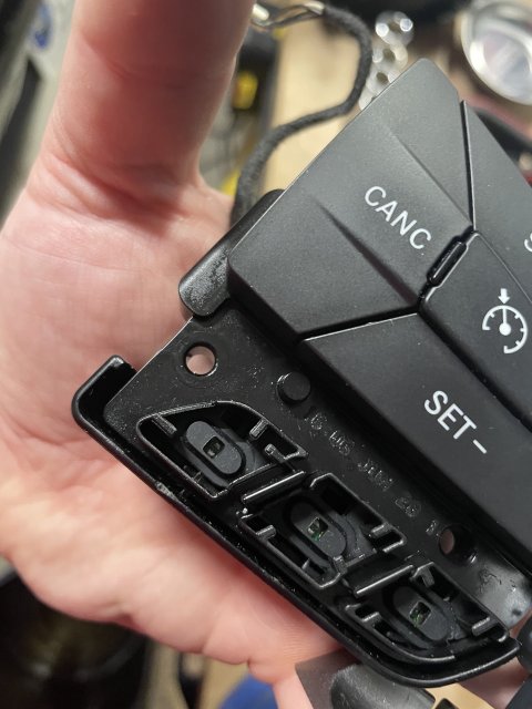

DB1046DD-771E-4FC3-8142-9E089CC84D65.jpeg Old on top, new on bottom. The module works and I have the buttons remapped to line lock, custom mode, cooldown. The unfortunate thing is the buttons I ordered dont work. I need the newer buttons so Ill be ordering those now.
Old:
New:
So if you have an early year Challenger with the old module, if you upgrade make sure you buy the right buttons for the new module. Hope this helps.

The original module may be broken or it may not be supported. The buttons may not elicit a canbus notification as they were never “programmed” to work. My friends 2015 M6 ScatPack had no issues, in fact sold my Z-Auto buttons to him. I havent taken the time to sit there with a probe yet but if anyone has any trouble this is the way to go with the parts listed.
