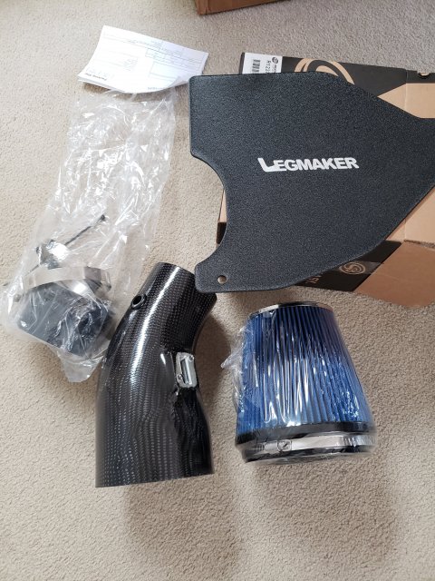

Got caught up in all the CAI stuff and picked up a legmaker. Not sure when I will be testing it but I will be:)

in coming

Nice. Can you measure that filter? Length,diameter and filter inlet diameter? I'm trying to source another filter with an inverted end piece to replace that metal cap on the LMI filter.

I don't like they used a metal cap either
Inlet is 6" ,cap is almost 5.5", length 7 3/4", filter at widest is just under 7.5"
Let me know what you find
Anderson Ford Motorsports has some nice filters. I looked and they have a 10" long and 6" long no 8"

Green filters has a bunch of sizes. Here is one but probably others that are better. I just need to search through them.

I already looked through Green I don't like the solid cap. 2382 is close
