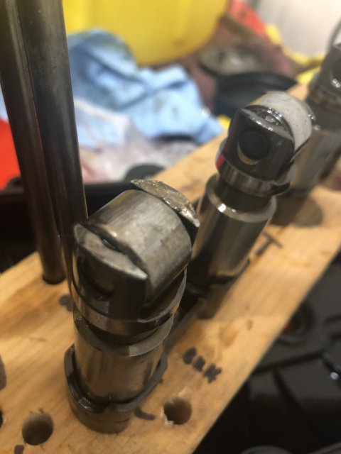

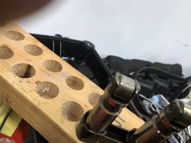

I now have the pass side head off and the lifters are out - here is what I found:
Intake lifter on cylinder#2:
another picture of the lifter:

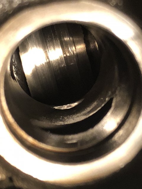

And the cam lobe for the intake side of cylinder#2:

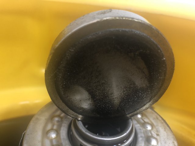

The cam lobe looks pretty good (relatively speaking), so I am relieved that the motor should be OK. I cut open the filter and it appears to have captured the metal shavings on the oil pump side of the filter and the amount of material from the cam and lifter should be minimal and contained in an area I can work with:
Here is what came out of the filer:
not perfect but the Mopar filter did it's job....

Does the lifter have a flat spot on it? Did the roller freeze up?

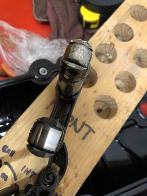

Yes, the roller has a small flat spot and the lifter is froze. The pictures are a little weak, but you can see it...
This might show a little better - good vs bad roller surface;
Yikes!
That really means the cam lobe is “wiped”. Sounds like you realized it right away. Cam is not good enough to just replace the lifters.

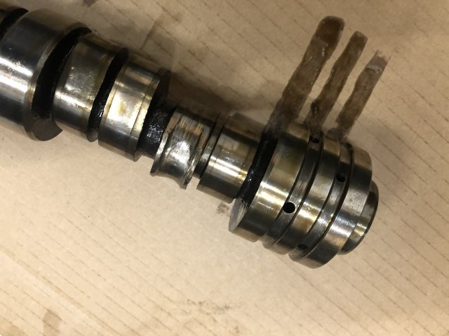

I finally got the cam out, and the lobe was worse than I I thought, looking thru the lifter hole I could see cam wear from the lifter but the bad side of the cam wasnt visible at the time.
575C9E6F-A4F3-4185-87DF-DBCEFE7E6BBF.jpeg I ended up pulling the oil pan and oil pump to clean everything out. The pump didnt show any excessive wear, but it did show some, so I am replacing it.
View attachment 26374 I ended up pulling the oil pan and oil pump to clean everything out. The pump didnt show any excessive wear, but it did show some, so I am replacing it.
