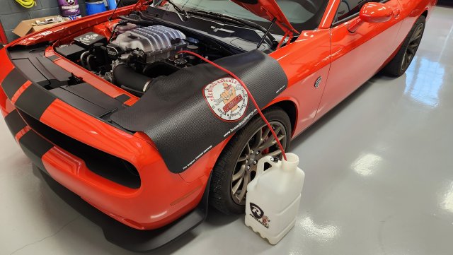

I have threaded fuel rail ends and thought I get get a fitting if I wanted to do that
7,541
19,793
Thread Starter #389
I tried welding an AN fitting on the end of a factory rail but I learned the rate of flow matters. It has to be restricted enough to create a vacuum so the passenger saddle venturi sends fuel to the driver side saddle where the pumps are. If yours are threaded will likely work, you just may have to put a restriction in the hose (like bending it with your hand or something).

Ive done this many times my 18 had the same thing. Some how my Scradder valve broke this year. I finally got it out. But now worried there is metal in the rails. So i need to clean them.

You cycled the fuel out, speedy turned it on and it emptied
I have a jumper wire. Just don’t use it unless it is full
