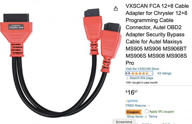

in the attempt the other day when they were scared off, I found this in my backyard…which is this https://a.co/d/0z2hzhs
so does the Igla prevent it from being successful? I think yes but I’m still not clear. I tried to get the TSB for the RF lockout done today and after taking it back, it said the Igla already creates a barrier and they couldn’t install the TSB… does this sound right?
Post a screen shot I’m not clicking on that sis link or image
