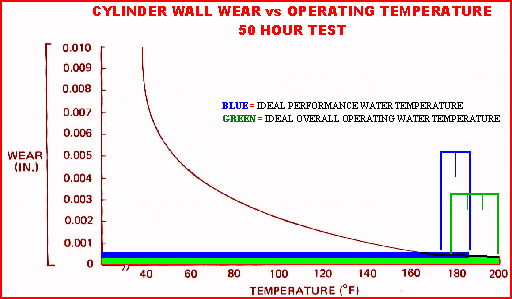

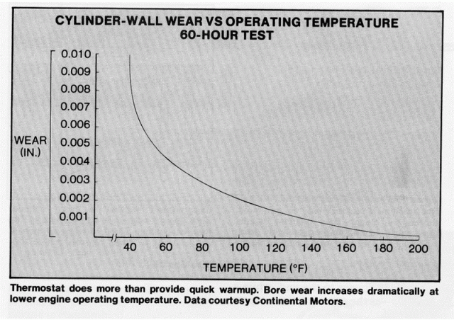

Yes, I am aware the Hemi Packages offer a 185 stat, but that does not change the physics of block expansion based on temperature and the end result. This is still current thinking; not old school at all.
The fact that rings and cylinder walls wear more with a lower stat has been known for 50 + years. There are even charts and tables about the subject.

Long-held idea or belief from whom ? The discussion is for only 15 degrees or so. If that is the case the motors would explode when running on the track and the temps get over 230 degrees. The Coefficient of expansion for various metals between cast iron ( 0.0000058" in/deg ), chromemoly ring ( 0.0000033" in/deg ) and aluminum ( 0.0000131" in/deg ) piston sleeves can be made out of ductile iron, steel, aluminum, iron, those are a lot of clearances to consider for only 15 deg so expansion rates can vary greatly. Hell the combustion in these engines is about 2800 deg f. and the EGT might be somewhere around 1200 deg f. .. are you saying that running the car on alcohol is bad for the motor too ? or maybe methanol that runs the motor cooler ? What is your opinion on running the car to lean ( oops that ICE motor just melted the pistons down ) on boosted motor the piston ring gaps are looser than on an NA motor to account for the pressures and the additional heat. The multi viscosity oils accommodate a wide range of oil temperatures to provide lubrication to the bearings and other moving parts in the motor. with running synthetic the lubrication doesn't break down like it did with strictly petroleum oils

Isn't it contradictory to use the data from an aviation air cooled engine ? This is why aviation air cooled motors require an overhaul every 1500 hours or so . When you're flying in zero temperatures you need to close the cowl flaps to keep the engine from getting too cold. Yes I would agree, there is considerably more wear when the engines are cold, but you are talking about 40 to 160 deg range. oil cavitation is a bigger concern on the air cooled engine at startup, and the lack of oil for lubrication of the cylinder walls when the engine is cold has a detrimental on wear. It's always a good idea to let the oil temperature get to temp before driving the car's hard
When was the last time a car's engine was overhauled at 1500 hours ? wouldn't that be like around 90,000 miles ?
Then do your own research. This is a demonstrated, proven & accepted fact for decades.
