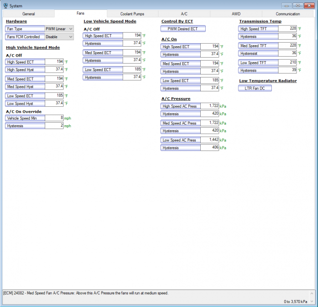

So I added a 180 degree thermostat. Manual labor was fun, had a lot of cool-aid in a zip lock, couple of drips here and there, added it back into the system and checked for leaks. Now my expectations were that as I adjusted the tune the fans would kick into ninja mode as soon as the temp hit 185. I didn't drive with music on so I could detect the fans coming on but the fans remained relatively quiet. Here are the tables I adjusted and the values they hold.
For High Speed Vehicle Mode, Low Speed Vehicle Mode and A/C On I set the values for Low Speed ECT to 185. Theory is that you want the thermostat to actually open before cooling, so at 185 a 180 degree thermostat should be open and the pump should be on. The fans then should kick on at 185 and the engine should cool off the fluid. At idle I was expecting the car not to see anything above 185 or damn near it, were my expectations wrong? Additionally I set High Speed ECT and Medium Speed ECT to 194. Since the FANS are PWM is there anything in those control options that I should adjust as well? Should I tell the fans to go full tilt?
I understand I may be asking too much of the system but do things look normal? Attached my log of after the install (had to add as a zip due to file extension restrictions)..

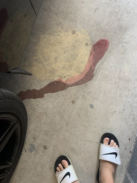

I’m definitely going to hit up the forums. Tested to see what happens at idle. Definitely hit overflow...
You would think the fans would turn on high blast in that situation. Log says otherwise... also know the t-stat opened as the hose had pressure and was not fungible when trying to squeeze it.

100% correct. I was tuning as if this was still a ScatPack, the changes you make in the High/Low/A/C On modes are for non PWM fans, i.e. 2 spd, 3spd or otherwise fans. You have to modify the PWM Desired ECT values. Went for a spinaroonie with the tables set and I didn't see a temp above 192 with spirited driving. Was a beautiful sight. Should help out a lot at the tracks.

Did you only change the Desired ECT table with the two temperature parameters or did you also keep the high/medium/low fan speed settings too?
Thanks!

2016 Dodge Durango R/T (PWM Linear Fan Type). Same as your SRT.
4,059
10,134
Thread Starter #20
so you only need to touch the desired ect table
