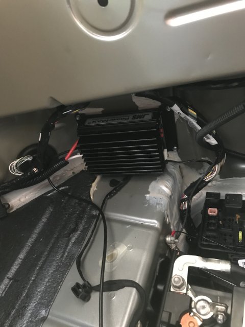

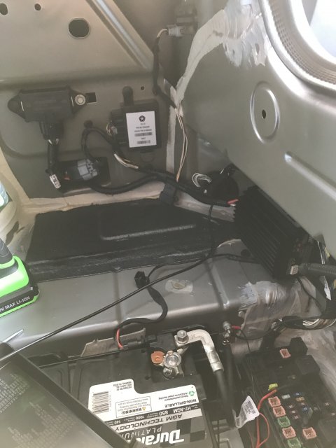

Just installed the JMS BAP EASY Install plug and play for our hellcat I did some research and there was no negative info on these that I could find A245EC99-B179-41DC-BA78-EC47E4CD2919.jpeg 726E7BC7-C26C-4C0D-8617-200991E2063D.jpeg

So like no cutting wires plug and play? That might be an interesting option. Is it boost referenced or how is it activated?

No wire cutting at all and it plugs into the fpcm and at the pedal it uses the throttle reference as to when to activate I’m setting mine to come on at 50%throttle and it ramps up from there to 100% when it’s wot I’m about to go make a couple of hits and log it to see how it does

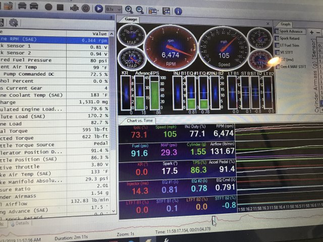

ok I did some logs a few hits up to 6500 wot the fuel pressure will hold 90-92 psi
it of course brought the injector duty cycle down to where it didn't go over 77 and the fuel pump duty cycle never went over 72%,i believe its no difference from added pressure through the tune except your fuel pump duty cycle is going to rise up if not max out at times out when that is done ,regular driving the JMS doesn't turn on ,if it continues like it is im one happy camper

17.5 deg of ign advance on 93 octane? WOW
How is the throttle position wire connected? Is there a reference in the trunk or ? I've not been a BAP fan, but this plug and play deal is pretty cool.
I'm not familiar with the 89% limit on the stock pump. In the tune you can easily see 100% is commanded.

it jms comes with a harness that plugs directly into the pedal position sensor at the gas pedal I just ran it from the trunk under the carpets to the gas pedal it comes prewired everything connected perfectly the trunk looks normal no sign of the bap is showing ..also that 17.5 is race gas I still have race gas in it from the track .it runs 14.5 degrees on pump gas 93
also that quote came from injected engineering ,when you are seeing 100% on fuel pump its actually maxed out it shouldn't see 100

Good info. I'm curious on this fuel pump deal now. Mine's set to 100% about 40% sooner than stock, so in my logs I see Commanded Fuel DC% and it shows 100.
