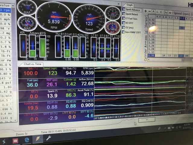

jack i don't have the afe and if you had hp tuner id send logs but mine is maxing out at times even after I cleaned it out I also have a new fpcm ,new pump and honestly wish I didn't have to get a boost a pump but I do agree with curt I need a safety net and he recommended it ,other then the trash possibly being the cause I have no answers even when I removed the first pump Saturday there was some what I will call lint like material on the filter ( will send a pic in a moment ) but the overall filter on the side you will not be able to see had nothing on it and the can part didn't have much of anything in it but yesterday when I pulled it there was quite a bit of trash in the can part but it wasn't like that on the previous pump here’s a pic I sent hpindy of the first pump I pulled Saturday and it maxed out to the point fuel went to 54 psi but in the log it happened right at the end of the run and I may have been letting off the throttle 860019DD-B14B-42E4-8671-3E8ECED43A2A.jpeg

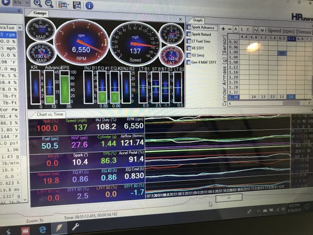

when the fuel pump maxes out the idc goes up we can see this in my logs remember I was thinking the injectors weren't enough but in fact the car was running out of pump but when the fuel pump let says doesn't go over like 85 % duty cycle as an example and the fuel pressure performs properly the idc is good ,even when its hitting 100% percent duty cycle my lamda is still ok probably because its tuned a little fat ,I sent you logs to look at you will see the idc go to 90 fuel pressure is at 73psi i believe,,look at the first log at around 83 mph right at redline in the pass you will see it,

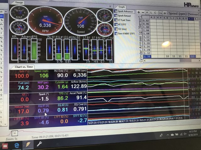

Here’s a screenshot so others can see what I’m seeing this was a pass Friday evening in race tune with the pump set up for 90 psi there are two areas in the logs 3D2578CF-595E-4963-B214-7D2120BB5065.jpeg 4834508A-B23B-46DF-8ED5-DBB31691C2E7.jpeg 8EF5D719-2BBD-40E2-8626-F548CABF518D.jpeg

it seems to me that when the fuel pump is spot on in the logs under wot you will see the pressure stay above 79 psi the entire time when somethings going on be it the pump state of health or a restriction at the pump you will see it drop down below that 79 psi or better threshold to like 73 or 74 psi and it may go back up but somethings causing it to do this,,when my pump spot on it never sees over 87% duty cyle and the idc never goes over 86 %

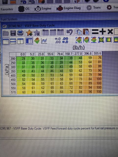

I took a look at my tune and my VSFP pressure is set to 100 a bit earlier than stock, so mine's gonna always show 100% at WOT due to the kPA it's set to 100% in tune.

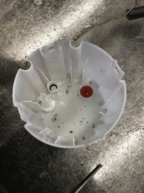

I personally think it the trash causing the fuel pump issues
Same as stock

Here is a pic I took of trash in the bottom of the pump , I’ll most likely have to pull the tank and clean it out 5744C583-817F-4F39-9C6C-7AD6AD0350BF.jpeg

I believe while it sat at the dealer they had the pump out and didn't cover the tank and that lint looking material ids the insulation from under the seat
