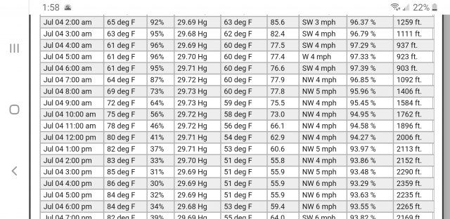

I'm using the kestrel as accurate at Napierville for a few reasons.
No nearby weather stations. All are about an hour away in or closer to Montreal.
The whole reason I bought this was because of the discrepancy in temperature at track physically or on the apps which are reading 15 to 20+ f lower which has to affect the DA readings.
2wks ago there was a racer that had a more expensive weather station. He is the one that mentioned temps in the 100's f and DA about 1100ft higher than the apps.
Another racer uses the track app for DA but has his own barometer and thermometer to log with.
His temps were off pretty much the same as everyone else's.
Here is the ADO app's readings for this day.
That just about 20f discrepancy will for sure affect the DA readings. As well as how far off anything else may be.
60,733
211,918
