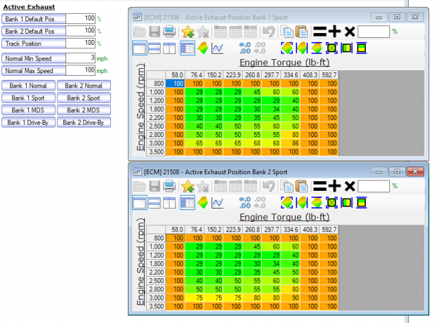

One thing in all modes, if the tranny is in Track Mode the baffles are open. Can anyone share if the same happens with the tranny in Sport?
In sport mode the tables do not have the active exhaust always open.
As you can see in sport there is certain criteria to be had to have the baffles open at 100%. This is my stock tune, on my race tune all modes except Drive-By (dunno what this does) have been moved to 100% open 100% of the time.

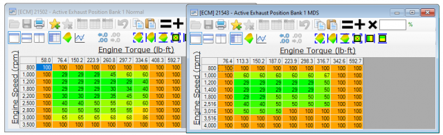

So what does the normal /street mode mapping look like - curious on how much more restrictive it is vs sport !

#48

Interesting, appears there is no diff but the documentation implies there is !

So I guess I missed something while reading this, Sport mode does not open the active exhaust flaps fully. Does Track mode open them fully?
7,473
19,638
#55
From what I'm seeing, all modes open exhaust valves fully above 3000 RPM and above a specific torque value of 334.6.
Track mode forces them open 100% of the time (see fumanchu182's charts above).

Where are they 100% in track, I'm missing seeing that.
4,795
19,289
#59
Post #44, top left of the chart under Active Exhaust ( Track Position = 100%)
From the MasterTech reference book p. 10:
"The Sport setting is more aggressive, and the Track mode locks the valves wide open, which is a place where the Hellcat is very comfortable (Figure 30)."

Thanks! I completely missed that. So now I'm wondering what happens in a custom mode?
