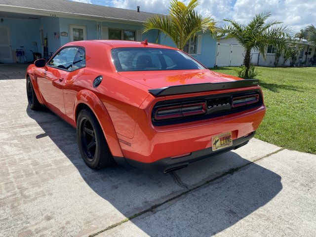

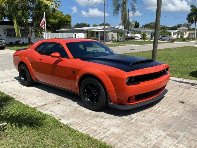

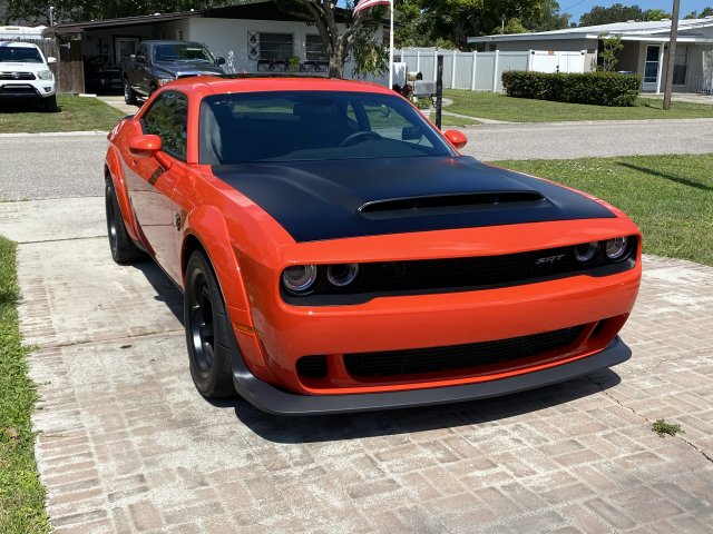

Here’s an update
body done - suspension done - chiller perfect - a few new tricks added and ready to go - should break a few hearts F4DD8BEC-337B-4D06-B7A2-B1EB0CEE30C7.jpeg 8247068A-7709-4AED-952C-897305802F22.jpeg 1D62A7A1-5484-4ADF-B6A7-EAE98A334366.jpeg A976ADB1-8A08-4108-A8E5-DC78C8772A65.jpeg 2F33177C-39A8-4C62-9CEA-45C9A66A58DD.jpeg

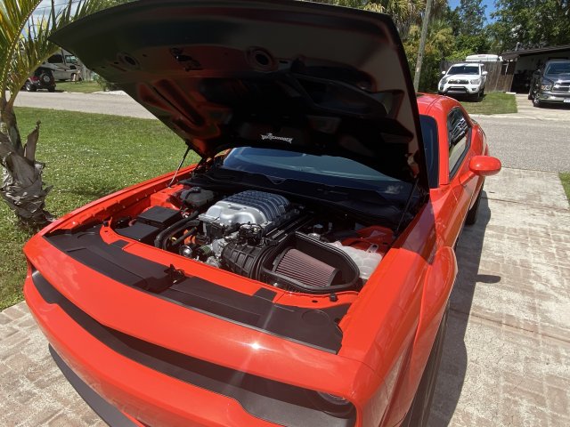

are you going to show what you did with the power steering pump?

Looks good, but I'm not on the upbadging thing personally. I liked the non-demon wheels best and it looked the business in that setup. You got the fastest color :)
it's not up badging if it is a tribute car:sneaky:
59,795
208,373
at this point it would look silly with Hellcats on it
there’s a metal ring in the ducting and the air box side - all you have to do is remove it, and it’ll bolt up fine with no issues - no mod needed on the pump - best part is the metal ring can be put back easily

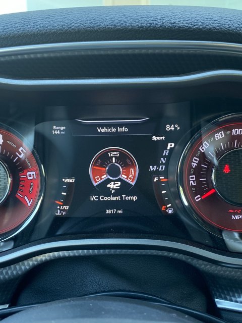

Nigel what chiller did you go with
thank you very much for getting back with me!!! I will be giving it a try
active Interchiller - Dave
