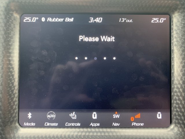

Is this doing an automatic update? (No warning or acceptance screen)
It was OK when I set off and about 10 minutes later I noticed the rear camera didn't come on. Far right button was Perf and has been replaced with the U, so I pressed it and got the please wait screen.
Buttons change to the relevant screens but no functions work. At least heating is set to 77, hard buttons don't seen to work as fan control had no effect but I can always open sunroof if gets too hot. Sat on drive for about 10 minutes, tried switching off and on again and then gave up and went indoors.
Shall I just go for a long drive to see if it finishes whatever its doing, I hope it doesn't delete my UK map.
