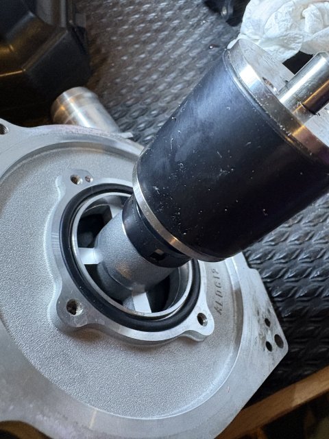

Yep, that front part comes off more and is most likely where it's leaking from. Not sure how to separate the front plate, you can see it's still 2 plates in the pic

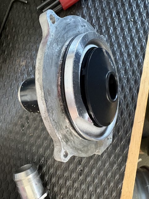

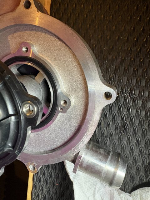

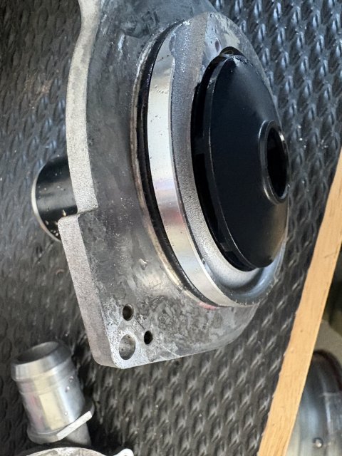

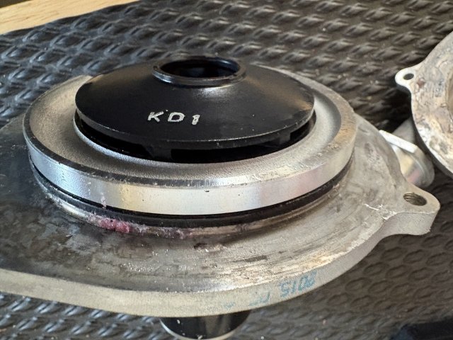

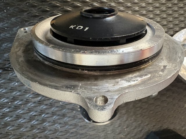

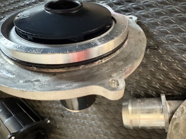

The pump halves seem to split into 1/3’s. Very little lateral movement on the shaft from side to side. I don’t know what’s within spec. O ring looks great. The mystery deepens…

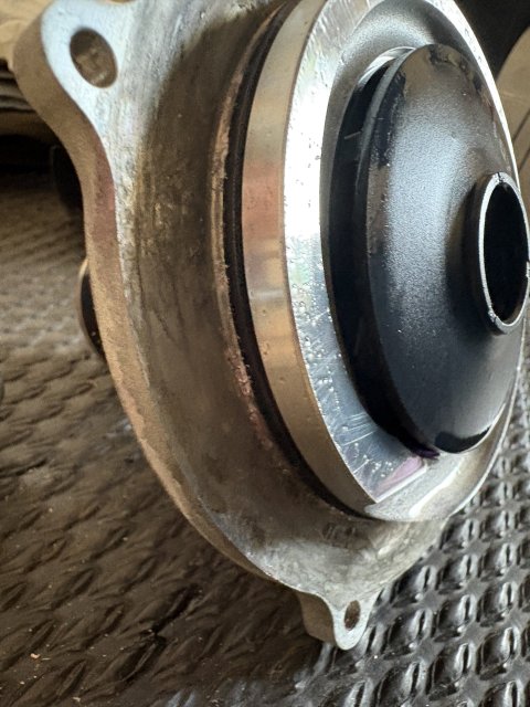

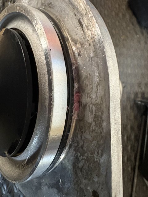

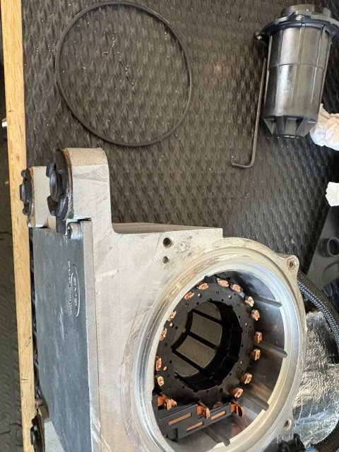

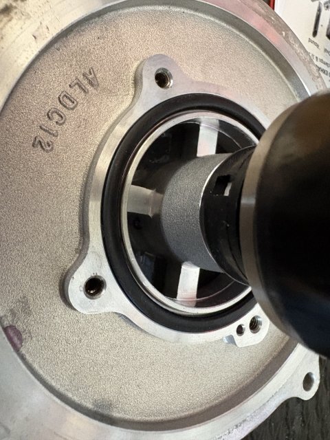

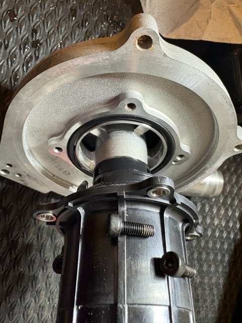

So all 3 portions of pump assy. disassembled. 3 o rings to replace (still need to measure)as well as thread seal the snot out of the assembly hardware. I don’t think I’m going to add paper gaskets between plate but I will Permatex plates when I reassemble.

That’s the culprit in these last pictures you posted, replace it and you should be golden. I would not use rtv, you’ll never get it apart again!! A new oring should seal it. 👍🏻👍🏻

Is the surface of the alum etched/corroded? Kinda looks like it in the photos, let us know. I agree to avoid RTV/Permetex if possible. But it helps when you need it when you have a bad situation and hope never to have to go back into it. If you are as old as me, I wouldn't worry so much! :)

Certainly seems a bit etched @2ndAmend. I’ll have to clean it all up, but I am having a prob finding proper sized o rings. McMaster Carr doesn’t seem to have them. Still searching. Never mind going back in, hell, I’ll JB Weld the pos together!!!

Did you have to take the plastic cylinder that turns the pup off the other side, or could you have kept it on? Curious what you had to do to get the front cover off
