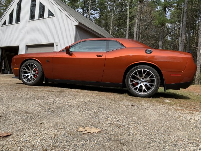

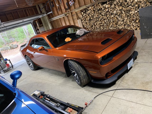

UPDATE:
As I mentioned in the What Did You Do With Your Hellcat Today thread, I finally got the spots out.
Maguires iron remover, water spot remover, clay bar.
I did not use the clay on the glass so there is still some spots visible. Next wash I'll clay the glass.
A lot of effort but it worked without buffing. Very happy! :D

Holy wood stack Batman.
What you see it next years indoor stack, the empty space next to it is this years. Then there is the wood in remote shed which holds about 1.5x the indoor.
