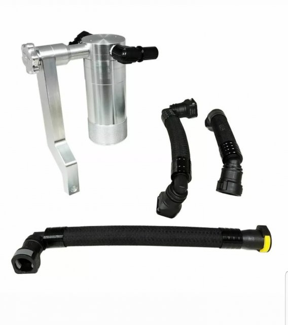

Anyone know what the third extra long hose is for? This is a UPR catch can...thanks!
Not sure what that hose is for as mine did not come with it. Just the 2 upper hoses.
10,109
28,022
Mine (on my 16) required a long hose and a short hose. Maybe an extra, just in case?

Kinda looks like one of the hoses for the fender mount. I have the fender mount kit on my UPR catch can... Added to yours by mistake?

Thanks guys, I have no idea haha, contacting UPR to find out.
Hunter - the hose looks like yours, sans the clip and locks that's already on yours. It's a braided hose from Continental and comes with aluminum forged fittings and a bunch of other fancy expensive looking stuff.

They supply you with a nicer hose to replace the cheap one on the drivers side valve cover

Hemiride is correct . I had the same UPR catch can on my 2015 hellcat . The longer hose is a direct replacement for the one on the drivers side .

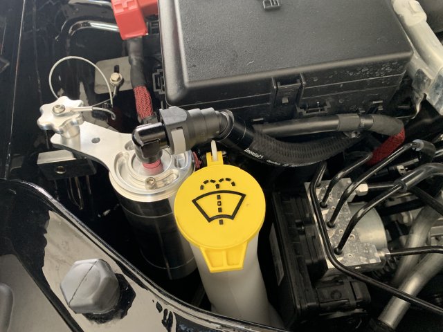

That makes sense - I did not get a driver's side catch can. I got the vented filler. For the fender relocation the hose is pretty long... (the one in the pic doesn't look long enough - thought it was just the perspective)

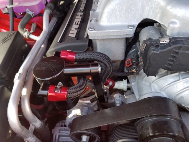

I just did the fender mount on my car and love their quality! U will love it! fullsizeoutput_49f.jpeg

The hose that came with mine was just a direct replacement for the oem one . On the drivers side .Its just for looks . It matches the one on the passenger side . I did not have a drivers side catch can . Again my hellcat was a 2015 .

You know there is a fender mount version. Perhaps you got one of those hoses.
