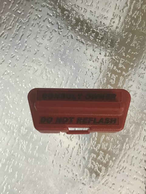

Ok, still on for Monday with NO PCM flash. I’ll get some pictures.
20,161
#50
Bob, folks are getting their tuned PCMs over-written at the dealer?
4,849
25,758
Thread Starter #51
Never ever let them flash your tuned PCM. I even fire a warning shot.
