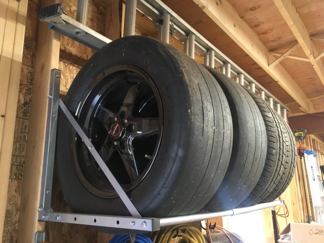

I also screwed a 3/8" lag eyebolt into the ceiling and made a block and pulley setup to lift the tire from the ground into the rack, but it ended up being a bit precarious so that's when I went to the pickup bed method.
If you look on top of the cabinets in the picture, you can see the rope for the block and pulley coiled up.

How many wide tires does it actually hold?
The tire rack brand I have that I showed has 2 315's and 2 305's on it. That rack says 400lb capacity..

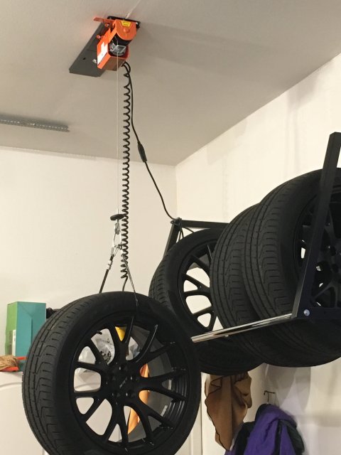

Buy another little electric toy to help. 22FD3976-B306-4088-91E2-F62DB999C158.jpeg

When you already have so many back operations you can remember, and mounted way, way higher than they recommend…
Buy another little electric toy to help. View attachment 68198
I want one.
Can I ask where you purchased the hoist from?
I was thinking that it might be nice to have a Tire rack shelf like how the hoist works. There are storage shelves made already.
In for the details on that small hoist..
So simple....yet so cool(y)
I don’t remember, and once the security system is off, I could get to the garage and look, but it is no more complicated than some of these that Northern sells. I remember I did disable one of the “double” hoist lines, and wire tied it to the pulley. Of course mount it so you don’t pull sheet rock down, and into something substantial. This one has the same control as mine, and seems to have a real similar description. It works great!
https://www.northerntool.com/shop/tools/product_200929978_200929978
