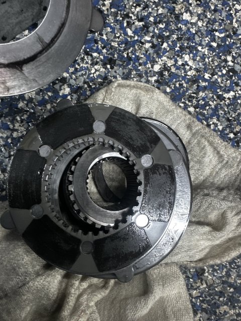

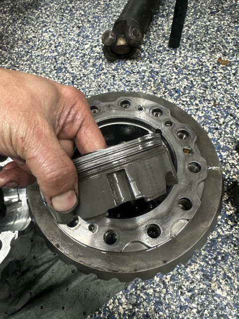

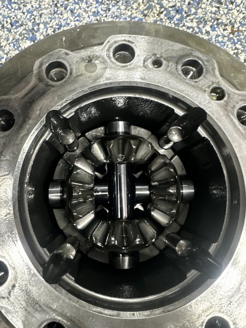

70415475331__4F3682E0-E182-42F0-8785-59B41E44D0FC.jpeg 70415474350__A4EEBABD-16D5-4686-95E5-DE4E74BB7236.jpeg 70415476890__05684356-D9DE-4802-9C22-05BC911D4B00.jpeg

can`t find after market or oem clutch kits for stock diff. do you know of anything? I have never been impressed with the oem diffs in these cars. I guess dodge thinks of it as a bic lighter, any problem buy a new unit:confused:
I have 3-4 sets of clutch’s. Can’t buy them separately have to get whole diff.

Just ordered my wavetrac thanks to speaking with @Hatermkr (also thats my diff he setup in the pics)

I have set up a couple. Nice unit. The clutch’s in a stock diff don’t have a lot of friction on them
Does the spline on the stub shaft have the same depth engagment as it does with the stock diff?
Yes to a tee
