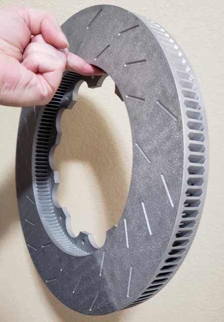

Here's an early prototype, the size and alloy are correct, but the internal matrix is wholly different, this is just a "basic" fin design by comparison. (Think F1) This piece has not been post processed yet either, so the finished part will be a bit lighter than shown.
We're still a ways off yet...
CDT Rotors
#2049
98
322
Frederick
Challenger Hellcat
Yes, that is less than 9lbs hanging off of that finger...
Edit: Actually, I misspoke, it WOULD be less than 9lbs hanging off of that finger, IF you INCLUDED the hat and hardware....
CDT Rotors
#2049
98
322
Frederick
Challenger Hellcat
And just in case anybody is wondering, yes, that is the 390 * 34mm front Hellcat rotor.
