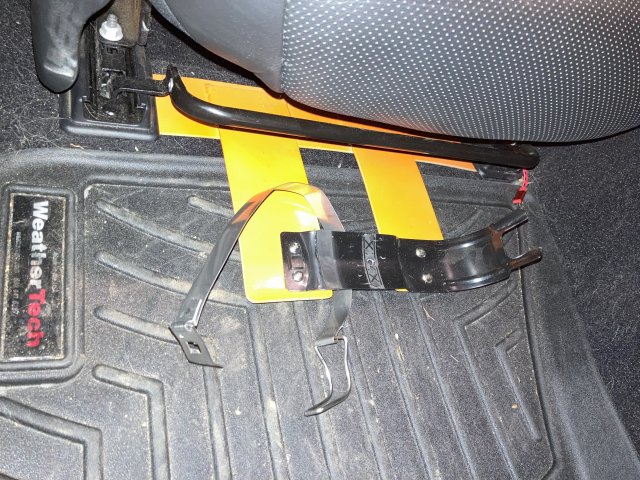

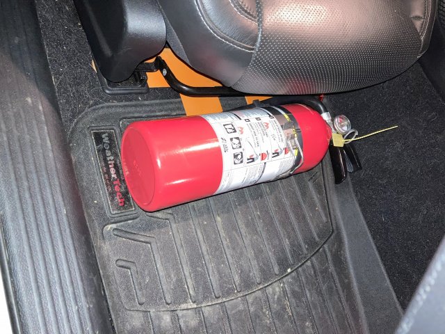

I mount a fire ext. in all my cars...(mounts to the seat frame...just behind yer ankles)..cool lookin instal as well..
I'm cheap (but you all know that!) and I made my own. The difficult part is finding steel FE brackets, they are all plastic now.

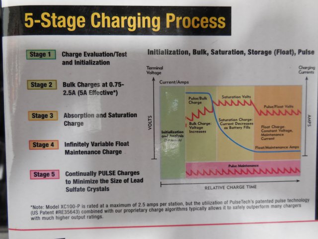

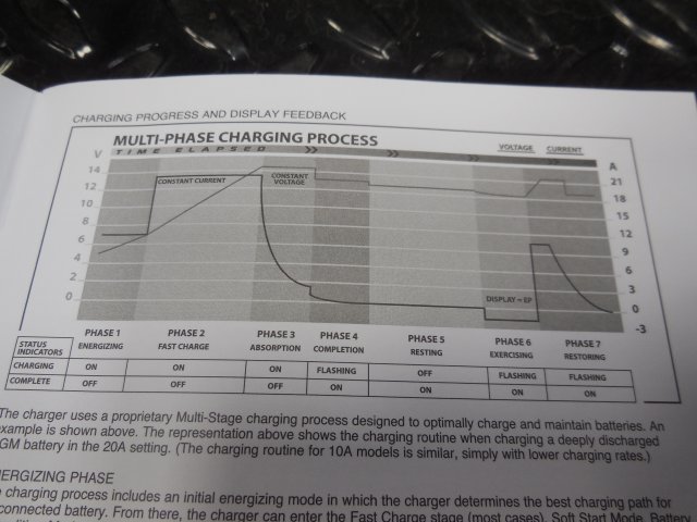

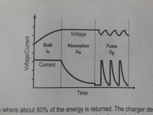

2nd, the voltage is only part of the equation. An important part, but still.
Took these photos today to show how some chargers/maintainers apply voltage and amperage. They range from basic (a $180 NAPA charger, but with 12/24 V capabilities) to a really nice PulseTech.
Yes, it doesn't require much to provide 12.8 volts to a battery, but there's more to it. Much more.
Sounds you lucked out with your HF unit (no fires) and got good life out of your battery. Okay,only a load test will tell if it's actually good. In that sense voltage means very little, if anything. DSCN5409[1].JPG DSCN5408[1].JPG DSCN5407[1].JPG

I'm not an EE, and I can read what it all says (great marketing btw), but the real answer is, "how much of a difference does it make?". I don't know, but what I do know is my batteries easily go over 10y and no fires yet. Hell, if HF burns my house to the ground, I'll just build a new one and let the insu co go after HF! :ROFLMAO:
