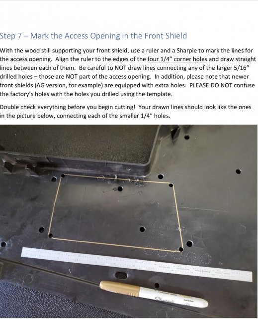

Yeah, but I use the access panel a member was selling a while back. It was $25 and eliminates removing 11 fasteners. Unfortunately he's no longer making them.
My oil cooler cover has those air dams (whatever they’re called) so at least that access panel cover wouldn’t work. I mean I wouldn’t be able to cut that open. On the other website, that guy selling those gave out the instructions for free.
I think draining the oil cooler for the first 3 or so oil changes is good enough. After that, I’m not sure I’ll bother draining it anymore. Not much oil comes out anyways. And if you change the oil often , you don’t have to worry about it Lol.

What's info on that drain plug? Looks like a nice safe place to put one.
It's a Fumoto F107SX
1,594
3,974
my year Challenger had nothing brake-cooling related in the way (looks like the above pictures), or I would not have interrupted it for the access hole
