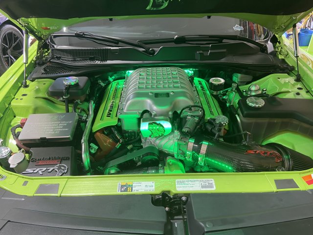

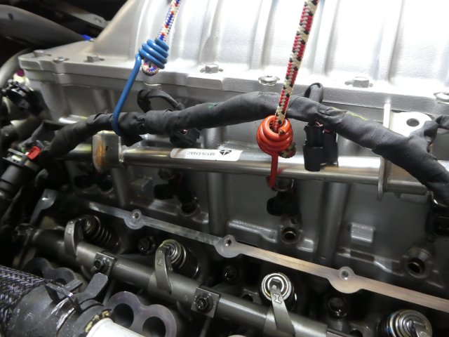

Hi Holy - funny you checked in...I'm on a lunch break after a session this morning and one yesterday afternoon and evening after diving into the sinister right hand side of these cars! All I can say is, I am glad I started on the LH side to gain confidence and dial-in technique and process, because looking back, it was quite a bit easier. All I can say is, it is one S-O-B to get that RH OEM valve cover even out of there, but it is possible. I installed new plugs and got the Blackbird one on this morning, and even it was not easy getting in - I cannot even imagine trying to get the OEM one back in.
Anyway, after surveying the wire harnesses and space available, I decided it was not feasible for me and my large meat-hook hands and my aching back to completely split the lower harness like I did on the LH side. I did separate the battery cable that is paired with the large alternator cable on the front lower corner, because that is one of many tight problem areas, and I wanted to run the battery cable that goes up, on the other side of the dipstick tube. Beyond that, I am going to use the harness extensions. I found them from MMX (P/N MMX-COILPAK-EXT $200 + s/h) - they are pricey but very well-made. I had a feeling I would need them, and I found no other ready-made options, and do not have the desire to fab something myself at this time. The kit comes with 4 short and 4 longer. I am hoping it ended up being a silver lining that I did not use them on the left side, because my idea is, to use 2 short ones on #2 and #8, and longer ones on 4 and 6, and pair up 6 and 8 and curl them around the rear and up, and 2 and 4 paired up and curl them around up the front, all joining the main blob up top and still look halfway decent. Worst case, I have to use the 4 long ones.
The final major hurdle awaits me after lunch - trying to get the 5 lower valve cover bolts in and started without dropping them into the black abyss with having the worst access of anything on that side. Everything else should be pretty straightforward - just buttoning things up and plopping the coils back on. Then, final plumbing the PCV and catch cans.

I was just there with my headers not long ago, so I feel your pain. Had to remove alternator to unplug oil pressure sensor (green plug with heat wrap)
Headers, supercharger, plugs. All the pain in 1 shot

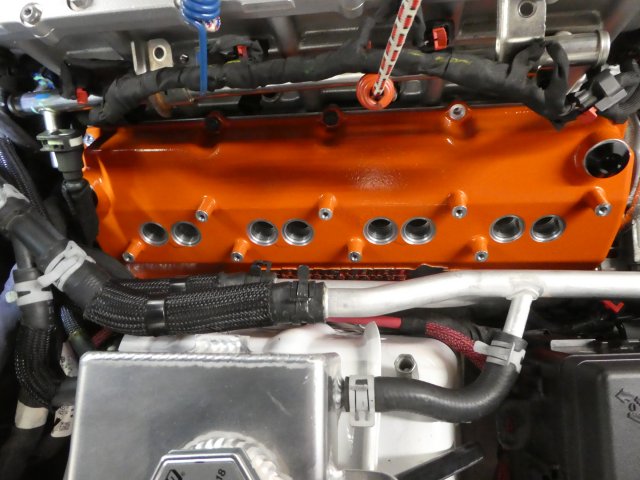

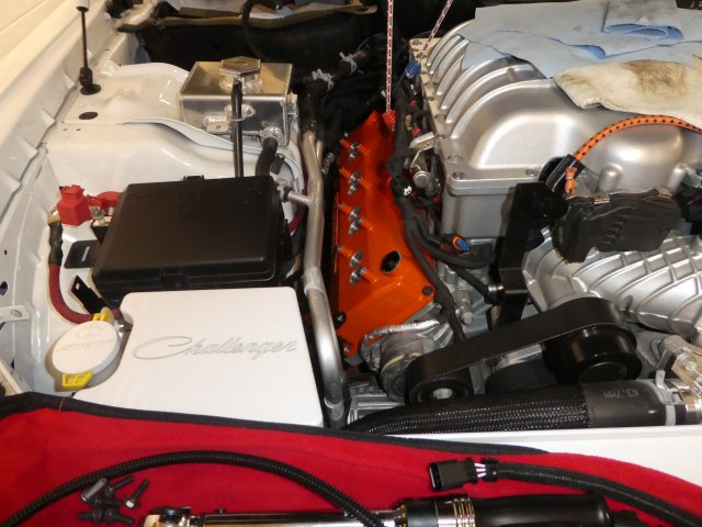

Here's a few up to the minute shots...my three hour lunch is over, better go try and get 6 VC bolts in before i take the nap i need :)

I’d like to see how much room you have for plug changes now on that side! Mind you I’m not doing them probably for a very very long time since I just did plugs ha
I can definitely share some final thoughts/photos if I ever get this done LOL. Long way to go still...but the long shot photo above gives a preview of the access improvement.
