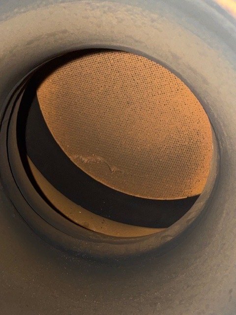

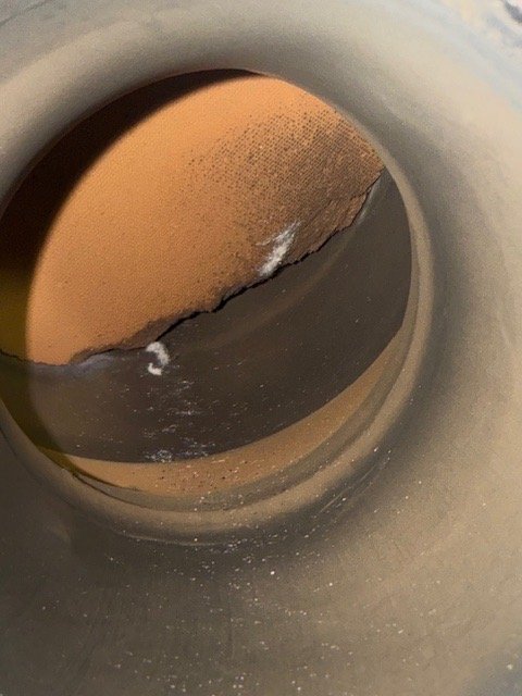

Finally got someone with a brain to look at the car. Well there was a recall for the cats and 02 sensors several years ago that I elected not to have done. So the left bank cat failed internally so bad it bent the 02 sensor. I’ll send pictures shortly. Both cats and sensors are being replaced under the recall. No,@Jon-MooredPerformanceLLC they are not flashing my PCM😉.
Here’s that cat picture. I didn’t get one of the bent O2 sensor. A used but serviceable one on the top and my bad one below.

At least that Kitty will live to fight another day! Great news and it’s covered under warranty I hope!
View attachment 163445 View attachment 163446
Happy it will be covered for you! All I will say is, the only good cat, is/a ______________ (I'll leave it up to each reader to fill in the blank ;))

@DGatzby
I don't recall exactly, do these look anything like your cats that shyt on themselves???
I don’t know. These are covered under the recall so I assume so.
Covered under a recall from several years ago but still active.
I never got mine done, makes me want to disconnect and bore scope them to see what they look like.
