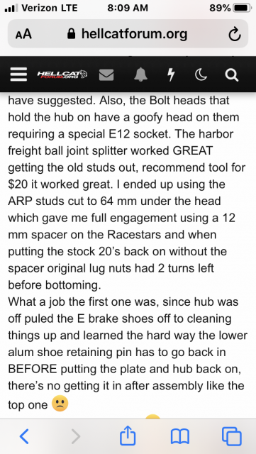

I need longer studs for track day wheel and rim combo. Are the studs removable and replaceable? If yes hassle to do or no? Wanted to put these longer ARP ones in

How much (longer than stock) bolt length?
Here you go, 64mm under the head

Still didn’t find where I wrote down a dimension, spent hours so far looking in the shop and in past posts and pictures, wtf did I do with the note????
Any ways, I found these pictures, 65 mm under the head more like it as I cut the bottom gold colored ARP stud down to fit and remember in my lathe cutting the round top off and about 5 threads off. I’ll measure a stock stud and add 12 mm to it and see what that number is. View attachment 12386 View attachment 12387 View attachment 12388 View attachment 12389
On my 16, I had 3/4 inch pass thru spacers. Used 1 inch longer than stock ARP.

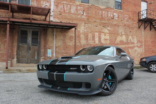

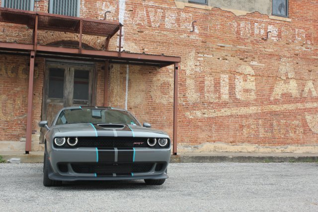

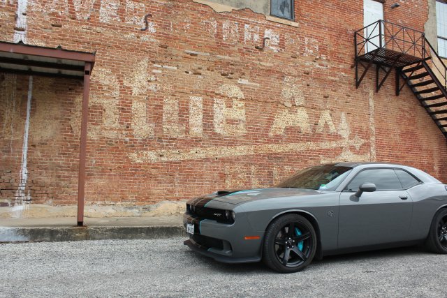

sry, just seeing this...destroyer gray
stripes go on Monday
This is late, but here was the end result

Different and understated, which is to say very good. (y)

Really, really, nice!
Looks cool!
