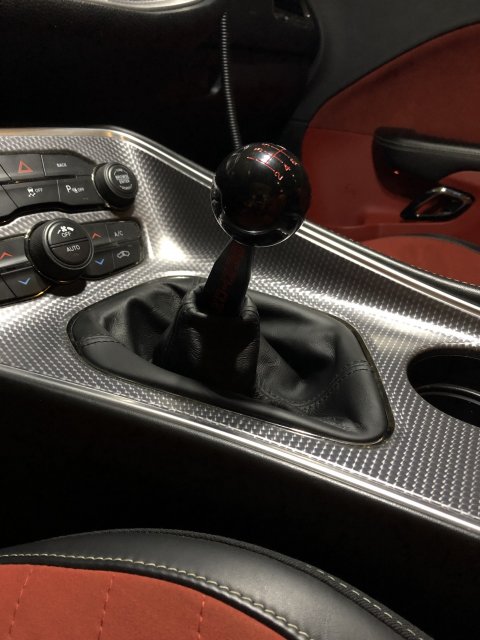

Ok funny story, my Barton shifter I ordered will be here tomorrow. I’m so excited, ready see the night and day difference and how bad ass this thing really is. So I start taking apart everything today to get it ready, and low and behold

This actually a good thing. You have the much more uncommon Barton that uses the original shifter base. Most buy the linkage with the Barton shifter and it works only with the Barton shifter. So your stuck with that whether you like it or not. This gives you a lot more options. Any handle style that works with stock shifter will work with it and you have the Barton guts and precision. You could go stock shifter for stealth or originality (which is what I did for a while) or swap for custom. I have a super rare out of production factory pistol grip (NOT the bent one that looks like the early 70's and doesn't fit your shifting position correctly) with carbon fiber handle or black handle depending on what I want with original looking shifter pattern font on top. I then custom fit this universal Hurst shifter and custom made ball to match my Hurst rims, which is on the car now.
This is on my '09 SRT8 not my RE.
That looks beautiful! Thanks for the info, yeah I gotta change from the stock handle. Its starting to show some wear

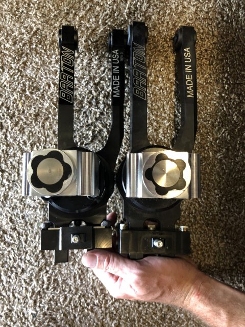

So I'm about to send back this beautiful new Barton shifter, but before I do, are there any improvements from the old type to the new type? Sometimes I get quite a notchy 1-2 shift and was wondering if this was normal for all Barton models?

They are at least on Version 2
It says it right on the support legs.
They've improved the geometry of the shifter.

Is yours notchy?

Maybe?
I have an original
As opposed to "notchy", I would call it either finicky or precise, but neither intended to communicate troublesome.

Can you post up a picture of the support leg graphics?
And then also compare it to what you've got?

Yeah now I’m leaning on keeping it. If so, I’ll start a new thread to compare them

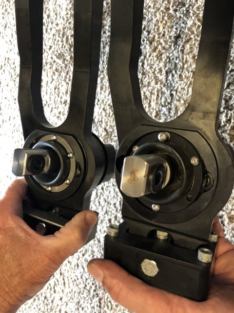

Was gonna start a new thread, but there is nothing to compare. They feel almost identical on my only road test so far. If anything the third rev might feel a tad better than the original. So I’m going to sell my old one on here soon for a good price. You can see where a few of those tiny Allen heads backed out of the bottom. Had fun time installing if nothing else

So what's the story of how you came to forget that you installed a Barton and bought a second one? :unsure:
I bought it used in 2018 and it had a stock knob and stick on it. Mine is the only hc m6 I’ve ever driven so I assumed it was stock. Experienced what I call notchy on some of the shifts, and since I already feel a slight disadvantage with a manual I was wanting to maximize that aspect. Wasn’t until I started pulling out the console I realized “hey look you already have a Barton.” At that point I figured people spend a shit ton of money on a few tenths and I could prob/might get that by putting on this newer gen3. Plus by this time the new one had been delivered and Barton wasn’t answering my emails or returning my phone calls about a return (covid related I’m giving them the benefit of the doubt)

It does say Rev3 real small on the leg
