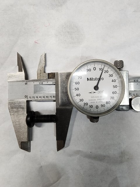

Looks like what I have are T30 head, M6x1.0 thread. I checked them with the thread guages in my tap/die set.
Threaded part of screw measure out to slightly over 16mm. I checked it with the depth gauge part of the calipers but couldn't hold it all and take the pic at the same time.

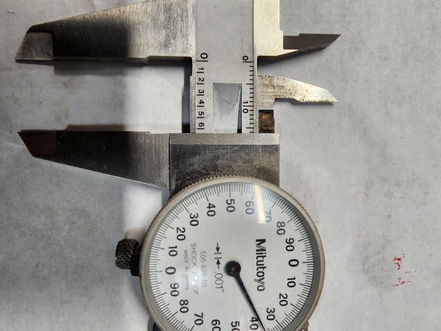

OAL of screw measures out to almost 21mm

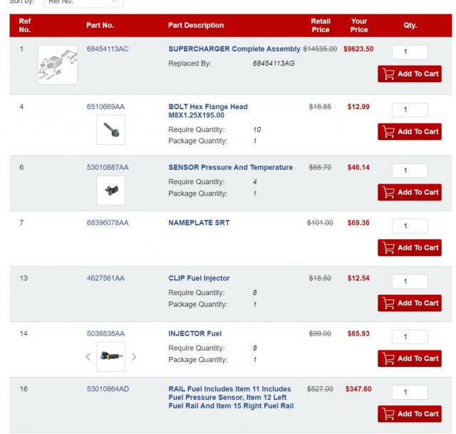

yeah, I looked them up too, they would be #10 on this diagram ...
and guess what is conveniently missing, skipping from #7 to #13 ...
That's what I found on eastcoastmoparts and another site as well.

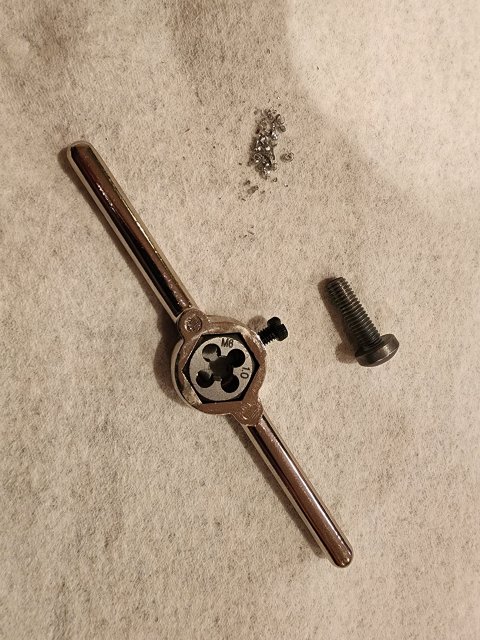

Alright, cleaned the threads on the screw. Quite a buit of material came off. See here.

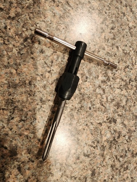

Then, using this
I chased the tapped hole. Screw goes in fine, a little loose at the beginning, due to lost material, I'd assume, then gets tighter.
