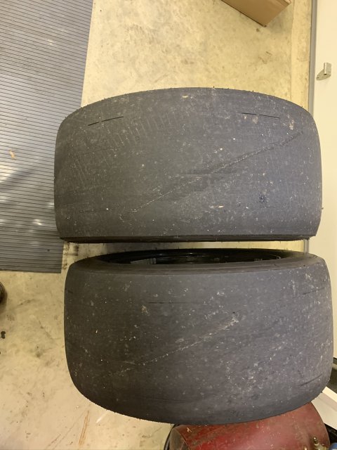

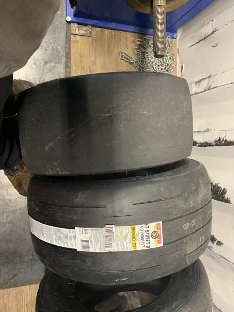

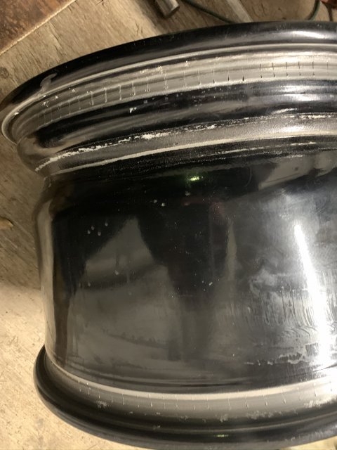

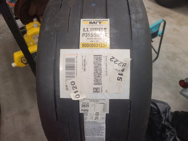

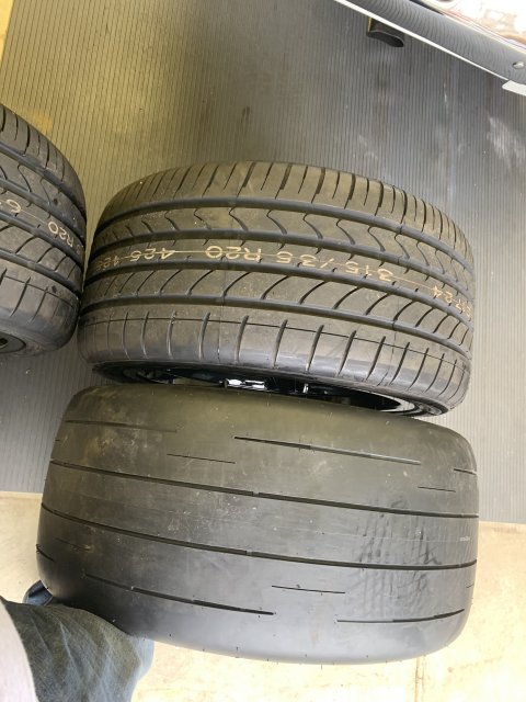

Got them installed yesterday. My 305’s were done. Sanded down the beads and notched them to hopefully keep these from spinning.

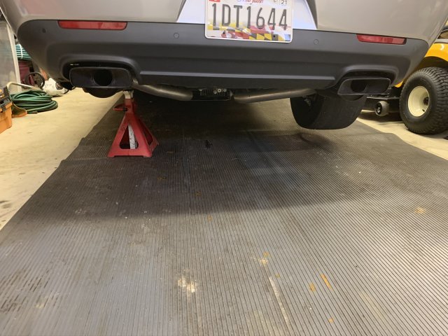

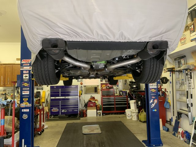

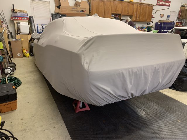

Crazy how ridged the frames are on these cars. Was jacking it up to put jack stands under it and had 3 wheels off the ground. 9F69301D-B5A6-45E5-860E-30E599ED82FF.jpeg 0801626B-9D7C-4572-9830-10AA4E1819D1.jpeg DA378A6A-6912-478B-B87F-13DC2DF7F074.jpeg

What did you use for the "knurling"?

Crazy how ridged the frames are on these cars. Was jacking it up to put jack stands under it and had 3 wheels off the ground. View attachment 9782 View attachment 9783 View attachment 9784
Notice the same on mine when I lift it. I've posted about that before (can't remember, hear or the other place). I'm surprised how many still feel need to brace and gusset. I guess every bit helps especially in road racing.

Just a sharp chisel. Roughly every half inch.

What is knurling ??

What a ratchet hand used to look like, done to roughen the surface so it’s not slippery vs if it was smooth. Good idea, did you angle the chisel so the “teeth” made bite into the bead Better if it tries to spin?

Nice job. Took some balls ,skill and ingenuity hittin' your rim with a chisel like that.

I'm serious. That wasn't a dig. (y)

If it works I’ll be very pleased. If not I’ll upgrade to bead locks. Was hoping not to have to make that jump.

Never used them. Somebody on here (can't remember who) had a thread about what a PIA they are.

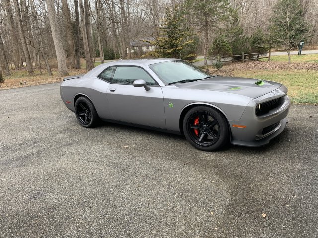

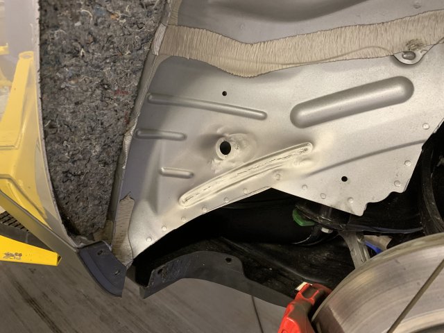

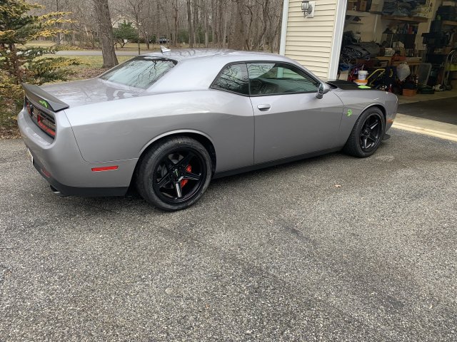

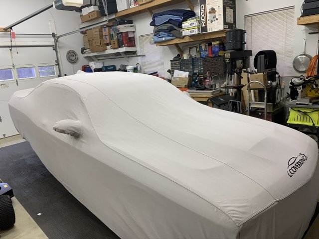

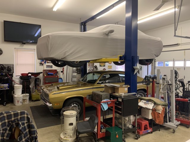

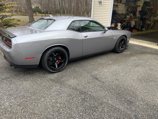

Got the new street setup on and made room for the new sticky’s! 67669F2F-296E-4F22-9782-7C5A60EA8577.jpeg 836ED99A-EB4B-4D1F-BD6B-854D73645569.jpeg 13924C40-C2F0-4FF1-8794-27ECACD9CFAE.jpeg 5AE8E532-24D0-48D7-9E45-D36C5A7B33E5.jpeg 55B85BB2-5955-4644-B1B8-2AA7FF9F9CB0.jpeg 27A730DC-8934-441A-8B17-68E0EB6679A3.jpeg 44422B3D-29DE-4E56-9621-14163BF0FA5B.jpeg 42622B5F-AFD3-4B97-8E2D-FD98054E9B5E.jpeg

I swapped over. Helped a little bit. Still can’t get my 60’ to drop under 1.45
I keep blowing the tires on the hit. I got to try taking power out of it on launch.
What is the front rim and tire setup in this picture.
Brand and sizes please.
bogart wheels. Mickey Thomson 315 in the rear. 17” wheel in the back. I gotta dig up the full specs. It’s been a minute.
