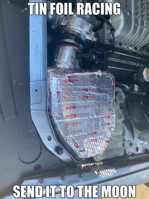

can you get some without the writing, looks cheap:p
Mines no garage Queen lol
but you shouldn't put stuff from the garage on it

never thought of using cooling duct tape on my intake
it's called "up-cycling" :ROFLMAO:
