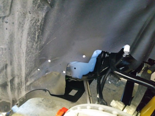

Same wheel dimensions. 17X10 +30 Fits no problem after a LOT of work. Yes they would touch that corner of the gas tank shield in full droop. But not enough to cause any problem mounting the wheels/tires on the car. So I left mine unmodified. I also did the standard wheel tub mod as well. Just so you know the Billet Specialties Win lite has .200 less back space. Just sayin.......... 0519201800.jpg DSCN2936.JPG
11,025
Same wheel dimensions. 17X10 +30 Fits no problem after a LOT of work. Yes they would touch that corner of the gas tank shield in full droop. But not enough to cause any problem mounting the wheels/tires on the car. So I left mine unmodified. I also did the standard wheel tub mod as well. Just so you know the Billet Specialties Win lite has .200 less back space. Just sayin.......... View attachment 68546 View attachment 68547

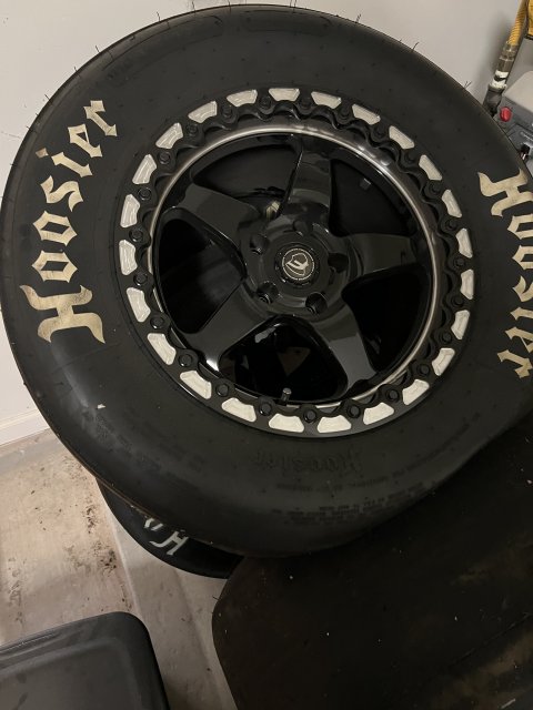

I have the forgestar d5s. 17 x 10 for the narrow body. And with the Hoosier radial slicks which are around 31 inches tall I do not get rubbing at the track. They are screwed to the rim. But when I get lazy after going to the track at 10pm and load the trunk up with 150-200 pounds of stuff they do rub. Maybe with a spacer they would not rub. I was thinking of running the Mickey Thompson radial front runners on the street which are six inches wide as compared to the 4 or 4.5 inch ones from the other manufacturers and a tall drag 17 inch radial on the back. Then no changing at the track. But I think someone told me the bead lock should not be run on the street. I can always not have them beadlocked.

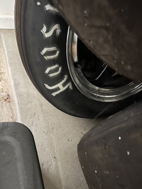

These are sitting in my garage all deflated due to time. The last time I was at the track was the beginning of January. At a da of 4300 they were good enough for about a 1.37 60 foot and a 9.60.
