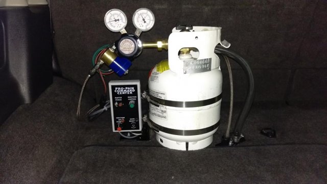

If only there was a way to mitigate the inconsistencies in pump fuel year-round with reliable on demand octane enhancement... hmmmm... if only.

No thanks. I'd never put a gas grill tank in my trunk. I'd switch to E85 before going that route.

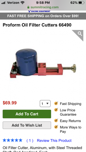

Haven't tried that. Got a cutter you recommend?
I use one of these from summit, inspect all high performance applications or if looking for issues. Once you start dissecting different filters you’ll be surprised the differences in there makings. My go to filter is Mobil 1 Synthetic filters at Walmart. Their exactly the same in side as K&N filters and are way better then either the white SRT or black Mopar filters for the 6.2.

That is a DOT tank (way more puncture resistant than a plastic gas tank), not one for your BBQ. Just because you don't understand something doesn't mean it isn't effective. That 5lb tank lasts for months and can be filled anywhere. Meth is expensive, very volatile, consumed rapidly based on weight, and often stored in a substandard containers - and E85 is a regional delicacy and unobtainable for many folks.
Propane shares a stoichiometric measurement very close to gasoline and is easy to tune for that reason... especially if you live on the gas scale and choose not to use Lambda.
I could just keep going on about the benefits but if it doesn't come ready-to-go from a known vendor it won't catch on in this community.

Motörhead do you run it ?
The picture above is from the back of my Procharged TBSS. I run propane year round in that 5300lb, 650hp, 11 second man van.
I also had a kit in my old Turbo Buick - 30psi on the factory original head gaskets for over a decade.
Hey keep talking. Very interesting. Think others would be interested also. Does that stuff just raise the BTU content of shi %$# gas to normal octane/BTU content?. Or would it benefit better gas also? Is it an octane adder, BTU adder, or cooling effect? Is it added like nitrous on a plate system into the intake stream or jetted separately. It must take very little for a 5lb tank to last for months. Why is this not more well known or commonly done if it's such a good benefit? I think this would be a good post on its own.
