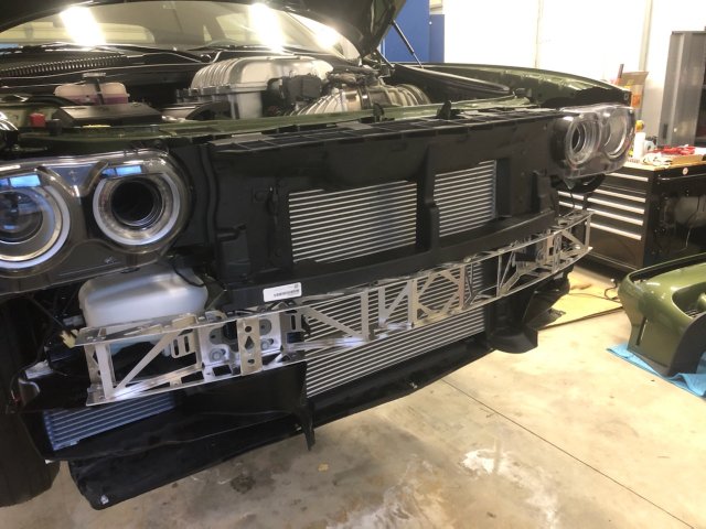

It is aluminum? What was before and after weight? I had been thinking something like this for the front
Yes it is aluminum. I am going to say it saves 8.5 pounds. I did not do before and after weights, but I did take the rems to the recycler and he weighed them at 8 pounds even (I did not take everything, only the big pieces).
My Friend that sold me the front bumper support also makes a replacement rear. But he did not have them in stock so I cut down my stock one. This is NOT an option for the front for me since it is steel and it is more intricate and would be much harder to cut.
Here is another picture of the front that he makes. It saves 15 pounds. vmacocss05_1292455888616-1-0.jpg

The front is a nice looking peice for nearly $500

Here is another picture of the front that he makes. It saves 15 pounds. View attachment 89645
