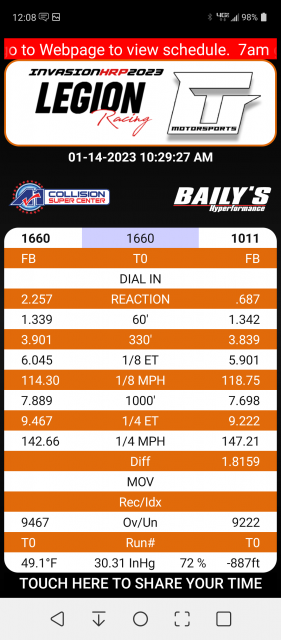

Your runs are with in .02 from each other so looks like MPH is off. Right lane looks to high in the 1/8th and to low in 1/4 maybe

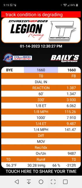

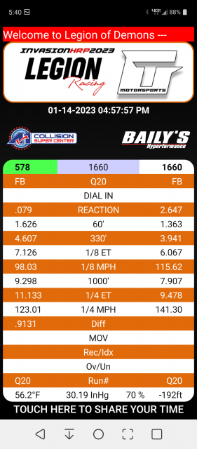

Congrats on new record 9.46 142!
Car ran almost exactly what it should based on the weight I took out since last year. Still more hiccups but a few good passes. Based on incrementals the car would have done 9.4X after 9.4X. But one hiccup and it slows you down about a tenth. I can't really bitch too much. We are so much lighter than OEM I am surprised the stock tuning has held up so well.
Reset the PCM and TCM adaptives again for the second time and I am pretty sure that is what gets the car down the track. But interestingly the fist time I did it the First pass was hiccup free and this time the third pass was hiccup free. Go figure. I honestly think it is just random luck when the tires stay hooked enough to keep the car from a hiccup. The Prep was better today. But if I got up on the converter too much it would spin. Twice I backed up to give it another go and it hooked. So cool they let you back up for a second hit............ 9.467.png 9.478.png 9.487.png
That 1/8 speed is legit and by far a record. What happened is that run was after that massive oil down in that lane. The car was actaully spinning and the stability control was coming on. It was scrunching the tires and it felt like 80 MPH gusts of wind was hitting the car head on. But, I stayed in it because there was no yaw. So that 1/8 speed is correct and the final speed was low by about 6 MPH because of the stability control. Look at the 1/8th mile ET. It matches the speed. Based on the other time slips posted I estimate this run would have been about .01 quicker than that 9.46. I am fine with the 9.46.
