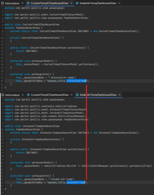

Decided to code an alternate route and just switch the data labels on the Dashboard.
So the Performance Pages file is updated. The one caveat, this would be specifically for 2015-2016 Hellcat Vehicles.
Unfortunately, the next step is to get the update to authenticate, and that might take some time to figure out.
