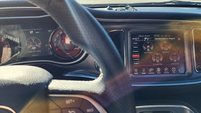

It's been several years trying to figure this out but I was able to finally track down the issue with the Performance Pages Gauge 2 Dashboard swap.
I've got the coding problem figured out. The challenge is getting the UConnect software repackaged properly so the car will authenticate/take the update.
UConnect Versions
18.45.01 - September 24, 2019
17.43.01 - January 12, 2018
17.11.07 - April 5, 2017
--- This is when the Hellcat SRT Performance Pages Gauge 2 readings between I/C Coolant and Intake Air Temp swapped ---
16.16.13 - April 13, 2016
15.17.05 - April 24, 2015
Issue (2015-2016 Hellcats)
UConnect 17.11.07 introduced a change in how the Performance Pages resolved sensor data. The updated code mapped the Performance Pages’ temperature gauges to incorrect sensor URLs (e.g., "LTR_Coolant" and "IntkAirTempIntrClr") referenced in the I/C Coolant and Intake Air Temperature Dashboard Views, resulting in a mismatch between the displayed labels and the underlying CAN signals.
The instrument cluster was unaffected because it continued to reference the correct CAN sensor IDs. This is why cluster readings for I/C Coolant Temp and Intake Air Temp remained correct, while the Performance Pages began showing cross-mapped or inverted values starting in 17.11.07 and all later releases.

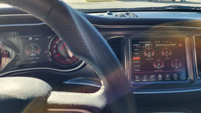

Ok, I want to confirm this, but I also want to make 100+% sure I understand what you've all been saying this whole time...
I want to confirm this because having never seen it, it is foreign to my understanding, so, you know, certainly is a fickle thing...
My center display gauges do in fact match the gauges in the Uconnect, and what you're saying is that the center driver's display has gauges swapped, correct? (I know, but I'm just being as clear as I possibly can be, being that MINE DO MATCH...)
My HC is a MY2016 M6 Challenger with Uconnect 18.45.01
4,666
18,807
It's the I/C Coolant & Intake Air Temp that are 'switched' on the G2 screen on our cars. They seem correct on yours tho, so it looks like it is not an issue for M6 cars.
