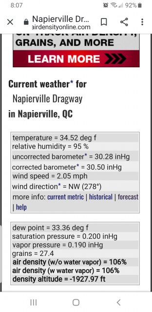

#62
You lucky ba#@&rd! .
This is the DA at the moment. Should be pretty close to that when the track opens. Imagine later in the month. Screenshot_20191004-213107_Chrome.jpg

Ok, surprise me, in what country are we talking about???
That's in Canada, province of Quebec

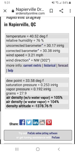

@Speedy! Just going to put this up for your entertainment. I know it will go up today. But it's a hell of a good place to start. LOL
