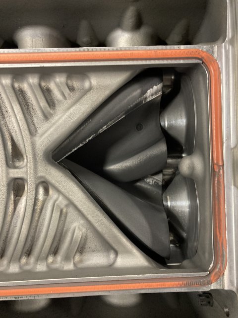

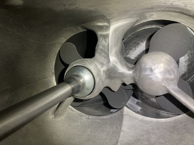

Check the rotors. Two easy ways to do that. Pull the lid to see the rear or pull the throttle body to check the front (easiest). The original billet version in the first picture. It’s got 30 passes plus dyno time on it now and makes a ton of power. Over 1400whp at 3000’ elevation thru a T400. It’s still in perfect condition. The second picture is thru the front of another that started eating itself. We’ve found that they don’t like rpm. Anything smaller than a 3.50 pulley is a problem. Stay tuned. It’s a saga. 😂 View attachment 132919 View attachment 132920
Mine’s a billet one as well, no rotor wear last time I checked but I think I’ll take another look.

Yes. We only use the +10 balancers.

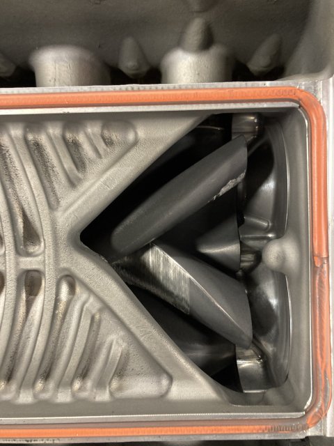

My last Gen 6 3.8 lasted less then 100 miles, 3-4 street pulls and 3 4th gear dyno pulls and the rotors ate each other and the housing this time too!!
+10 ATI lower and 3.50 Satera CLUTCHED UPPER PULLEY and it still failed!! Dusted my engine so bad with aluminum dust the oil sample analysis drawn with oil the that only had 100 miles on it as well picked up the aluminum in the oil!!
View attachment 132944 View attachment 132945 View attachment 132946

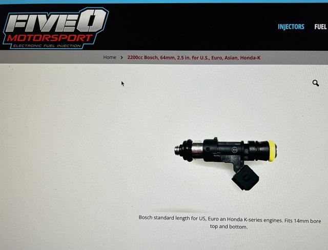

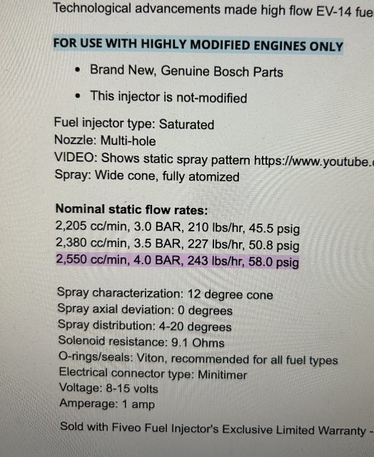

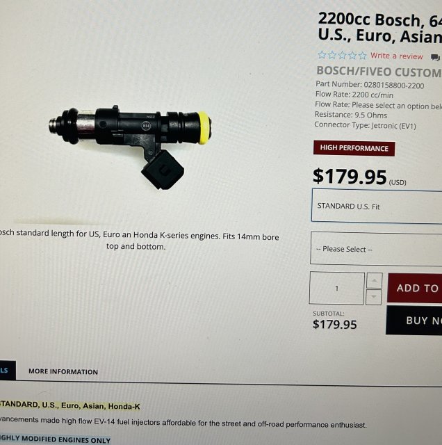

I'm beginning to wonder myself if I would rather pay for the fuel system or the cost of fuel. Either way they have you by the balls.
The injectors alone are more than double what my dual pump system cost originally. Oof.

Will need at least 2150's, triple pumps, and 2 baps.

Q16 will be very tough on spark plugs and o2 sensors. so expect some additional maintenance there as well. believe me I often consider my options going back to it. Pros and cons to both
