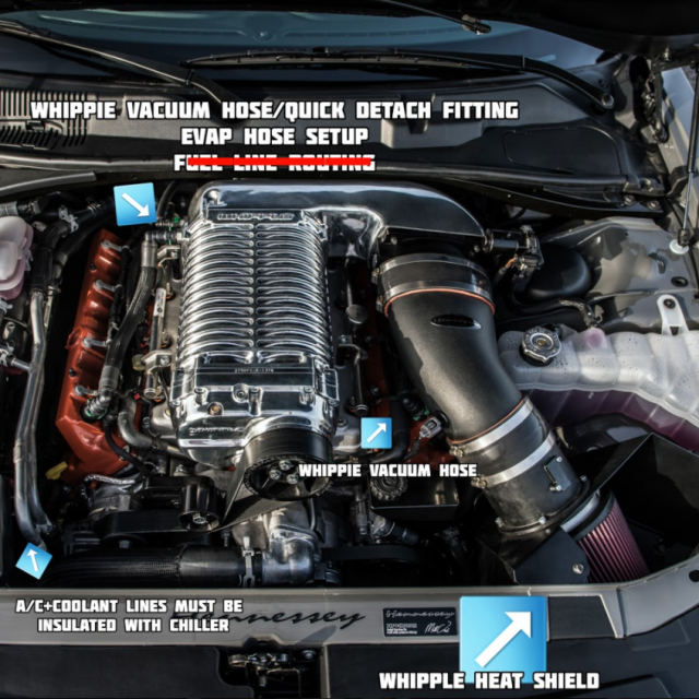

Here are things noticed installed wrong so far:
  1. -Wrong vacuum fitting - needs whipple specialty 8AN o-ring to 15.82mm quick connect.(Photo attached)
  2. -Missing the correct Whipple vacuum hoses/QD fittings.
  3. -Evap hose setup is a bit odd
  4. -Fuel line routing is odd- 3 points of contact. Covered with DEI 3000 Fire wrap for safety in the meantime. - Would like to retain the wrap when adjusted. Needs heat shrink on the ends for clean install.

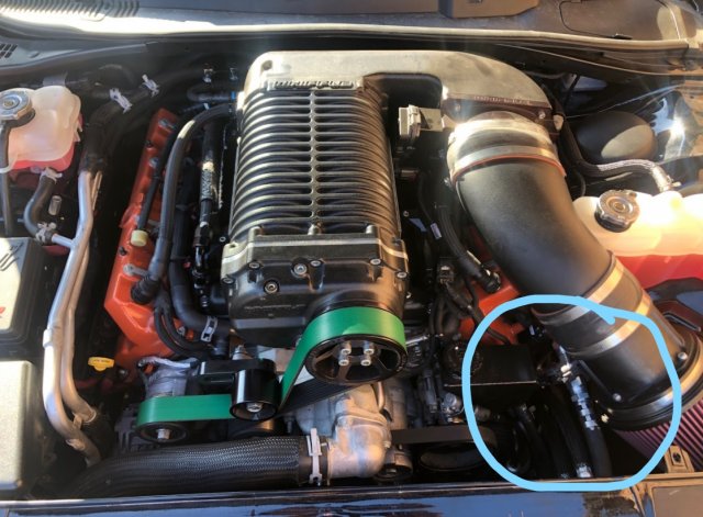

Here is a picture sent end of last week saying the car is complete: (Nothing was touched but the fuel line, told me it had all new whipple lines that were ordered when it still had the temporary hoses I installed in the meantime. Exactly how it left my hands :confused: - No insulation on any coolant/A/C lines )

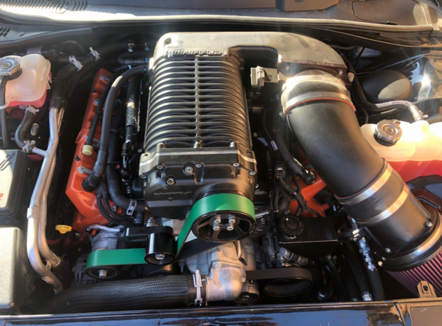

How i requested install and even sent this photo to help as a reference, it's little things but the only stuff i sent the car down for apart from tuning/chiller install, not sure how it could be missed:
