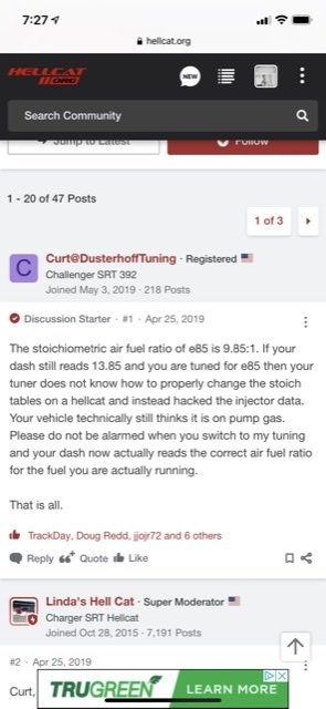

Here is a post by dusterhoff tuning. https://www.hellcat.org/threads/attention-all-modified-hellcats-running-e85.230179/

Again I did not state the stoich is 13.85 for e85. Speedy does not know what the heck he is talking about. He states things I have never stated. Any one who makes lame ass videos as a substantial part of his life has problems. I have never liked the little guy and never will. A little power trip guy.
You tune in lambda. It is perfectly fine to leave the preprogrammed stoich at 13.85 on the hellcat. The stoich for e10 is 14.1 or so. So the engineers at Chrysler messed up? No they did not. Because tuning is done in lambda.
Tim Barth my tuner left the stoich alone at 13.85. It is fine. Dusterhoff is not God. A lot of tuners leave the 13.85 in there.
OP, your lambda is too low for pump fuel. 10.5/13.85 is even a little low for e85 which has different lean and rich maximum powers than pump fuel. You are leaving power on the table and if tuned at partial throttle too rich you can foul your plugs.

Bingo @jonx96 guess what my dash reads at idle on E85😎 I wouldn't say using the injector method is wrong per se but I wanted to set mine up as if it were factory tuned for E85. Takes a bit more work bur worth it IMO.
Plus when you have tunes for pump gasoline and E85 you'll know which tune and fuel is in the car by what the dash gauge reads.
If only we could change the dash to read lambda. The car actually reads lambda and converts to afr so woulda been an easy option.
I can see this being confusing for people new to these concepts. Gives me a content idea for another lame ass video:ROFLMAO:
