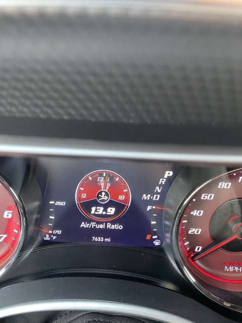

Curious if youve had an opportunity to apply the Stoic change to a newer Hellcat? In the past (at least on original NA vehicles) Ive always input my injector data and commanded the Stoich I wanted and let the computer do the rest. For some reason when I did that in my Hellcat it wasnt happy, so I had to "hack" my injector data for e85. It took some slight tweaking but not too much.
I have been told that in 2019 (or maybe 2018) some of the logic changed and some of the ways of doing things no longer work properly.
I never get too much time to play with my personal car so there might be another outside setting I havent found yet. BTW I did finally get a pic of my AFR gauge in my car for you
