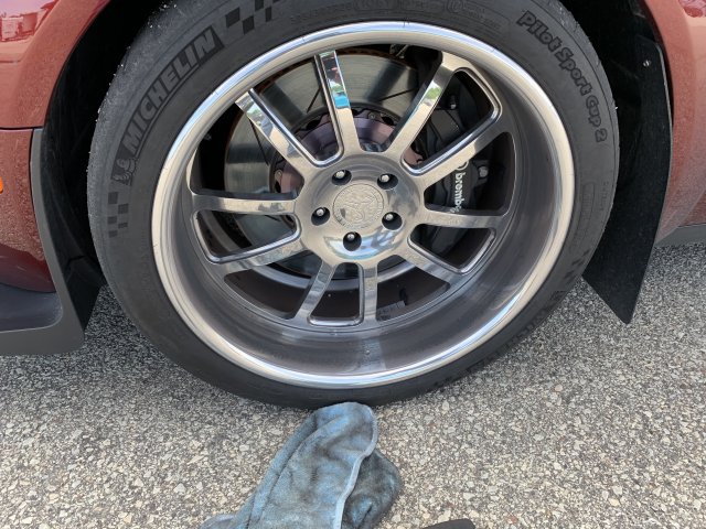

DGatzby clued me in on getting some dedicated street pads, which I am in the process of installing. I'm trying the PowerStop Extreme Z26 pads. I like his idea of swapping rotors and pads as "matched sets" too. I might try that next spring and summer.
Hawk Pad dust-
before...
Taking that dirty microfiber and using it lightly like a broom on some really nicely prepared and built wheels;); after...

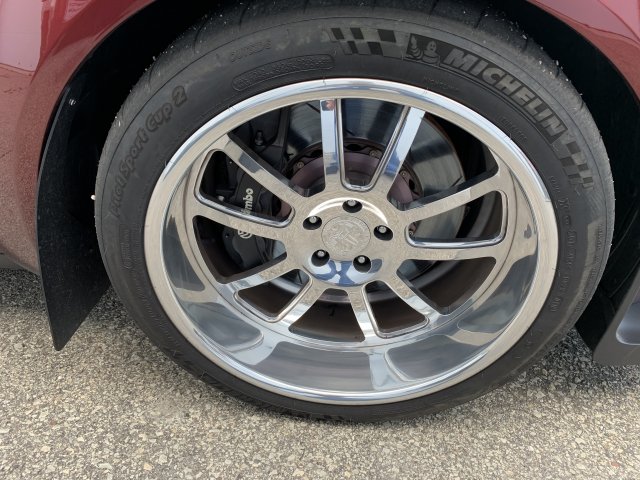

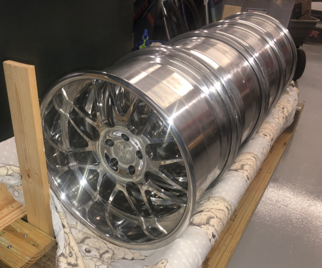

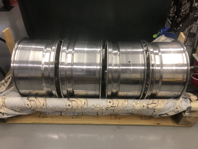

All,
I just received custom wheels made by triumphforged.com. These are the RX-16's. Bismarck Alvarado made the "program profile thicker than average" to better stress them for road course driving. DGatzby's sharp Roadster model wheels were also made stronger by Bismarck at his request. Thank you, DGatzby, for recommending I get some wider wheels, specifically through triumphforged.com, and dealing with Bismarck. You and he did the design work to ensure the wheels fit on Challenger Wide Body cars and don't interfere with the brakes, or rub. It was a pleasure working with Bismarck - you can tell on the phone he's excited to create such functionally beautiful wheels. He has a nice gallery of his wheel models on various cars at his website.
These are bolt on's - no spacers required - and he provides lug nuts and a special lug nut tool.
The two to the left are rear 12" wheels (they measure 13" outside edge to outside edge), the other two are front 11" (12" edge to edge) - they look bigger than I imagined. Thanks to my wife for the old sheet *grin*.
Over the winter I'll get some tires, which have been difficult to buy in the sizes I want. The word is Michelin is producing them at a faster rate now.
Many posters have made the point that wider wheels and wider, stickier tires than stock are worthwhile aftermarket upgrades.
