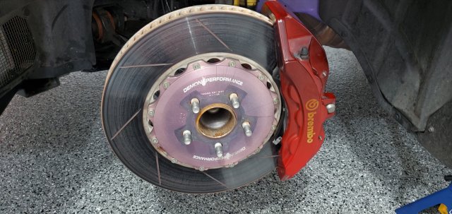

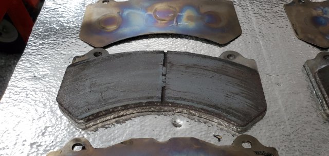

In addition, regarding the brakes, here are pictures of my front calipers and pads. The DTC70 front pads were new for that day at Brainerd. The caliper discoloration is due to heat, I believe mostly at Road America. Heck, Kevin Wesley showed me that his rear calipers are discolored like that too. :oops:

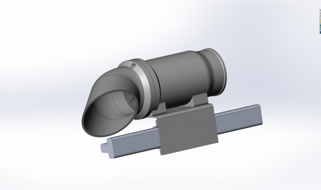

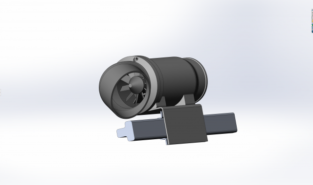

5.5ish
80ish watts
Not too bad

Ok. That's better than what we initially discussed I think. I still have my 2 I plan to install by next spring unless you have something ready before then.
