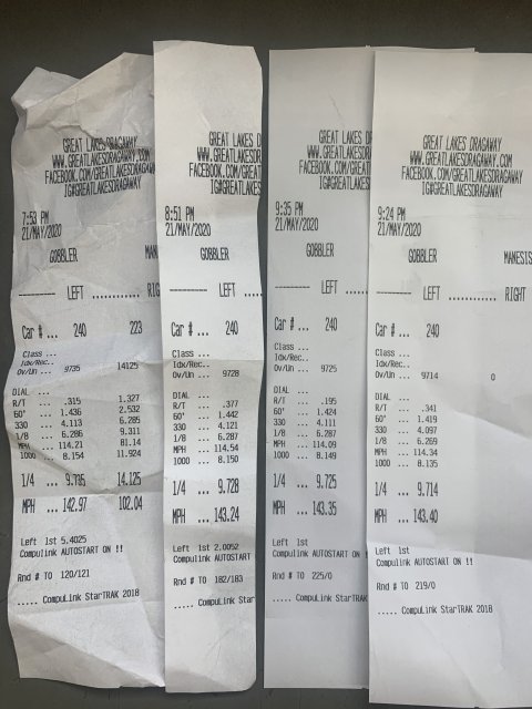

Alright guys, looking for some pointers.
not going to run the car again until I make some changes
More Power I think is off the board right now, I should have plenty to go 9.5/9.6.
I have cradle lockout , rear sway bar end links and a diff brace - that’s it.
cutting a 1.5 flat 60’, I think my 3.70 is to blame. Consistently running 9.90 or 9.8 @ 142/141. This is what I’m thinking
- 3.09 rear diff
- adjustable camber arms (rear)
- menscer coil overs (front and back)
anyone here run this combo? What’s your 60’ like? I have 315/50r17 MT on 17x10 beadlocks. Should be making close to 900 at the wheels.
I’d really appreciate any advice, or tried and true setups anyone has experience with.
thanks again

I had a 3:90 shipped to me on accident when I bought my billet diff. Switched to 3:09 no change in et or mph.

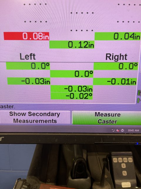

When my car was more stock went down the track every pass This is my rear alignment pulling down the rear end like it’s leaving the line. Trans in sport Susp in street. Held traction button in to turn that all off.
0D93A0D8-CD73-4457-B8A2-521D022530EF.jpeg E589089C-A692-4B04-9411-3A55EBA25EBB.jpeg
5,562
4,602
View attachment 104619 View attachment 104620
So you ran the same 60’ with a 3.90 as a 3.09?

The AAD arms will help and set the canber to 0.25+ on both sides with you in the seat .
That alone should get you decent 60's
