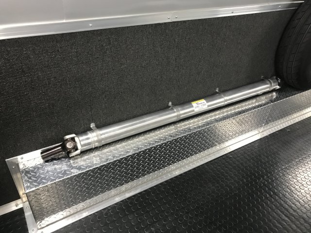

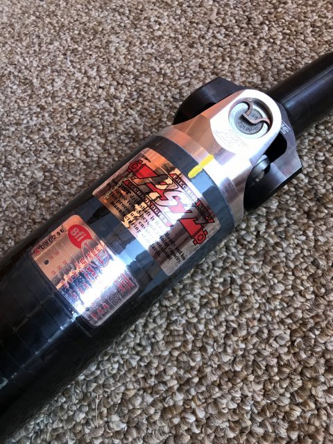

They’re not. Friend with one in Calif broke his on the first pass. I have a PST CF as my primary and a Raven Engineering aluminum as my backup. 6C916A93-D611-4D6B-9180-06F88ADCC955.jpeg 74A263F4-9460-43CA-81A3-91C3CBD3C80F.jpeg

They’re not. Friend with one in Calif broke his on the first pass. I have a PST CF as my primary and a Raven Engineering aluminum as my backup. View attachment 104662 View attachment 104663

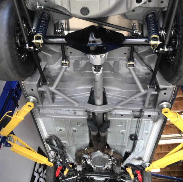

Strange Engineering DragPak conversion. 3.40 Pro Gear with a 40 spline spool. D7F0ED9C-EE18-4BC0-B694-B86A4FFA2E8B.jpeg
