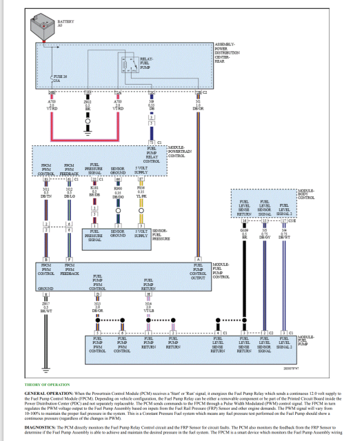

Is this of any value? this is in the Charger electrical diagnostics manual ...

@HWDan super helpful. Thanks for providing this info. I'm trying to determine which pin on the FPDM connector correlates to the fuel pump relay. Looks like pin "A".
@HWDan is this in the documents you posted? I can't find it and was hoping the pages before or after may help me. I see a couple things different than mine for example Fuse 26 in the diagram says 25A but if that's indicating the fuel pump fuse that's Fuse 21 in mine and it's a 30A.
I'm also puzzled by the description on PIN A of the FPCM (the dark blue and orange wire) indicating an OUTPUT when it's obviously being fed by the fuel pump relay making it an INPUT?

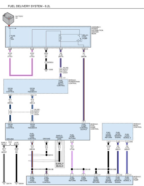

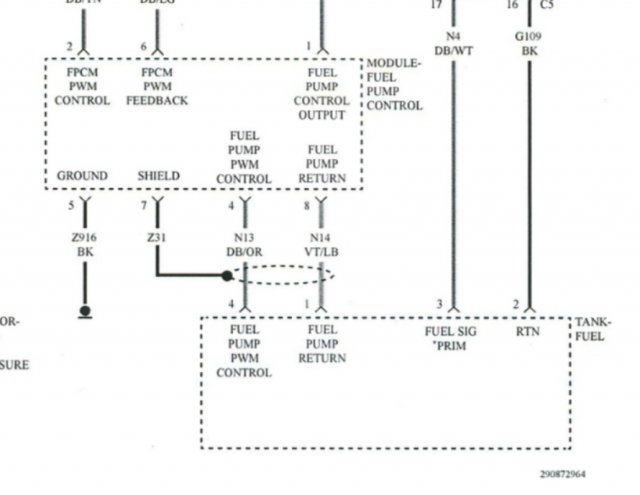

I Have 2015 Challenger Tech Authority wiring

Can you post or send some images of the FPCM info like above?

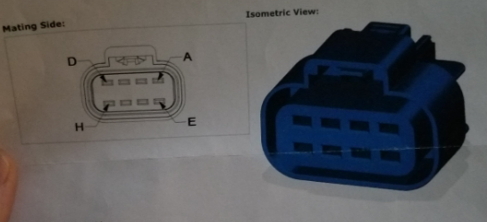

From 2016 connector database:
Maybe there is a difference in the Charger here?
I trust that now @Chuck and @Diboblo can pinpoint exactly what you need to see.
(although even Diboblo's PIN diagram shows A dark blue/orange as the output unless the terminology is reversed depending on perspective)

is that what you need

Thread Starter #20
That's lining up with other diagrams so I think that's what I needed. Thanks for the help all.
